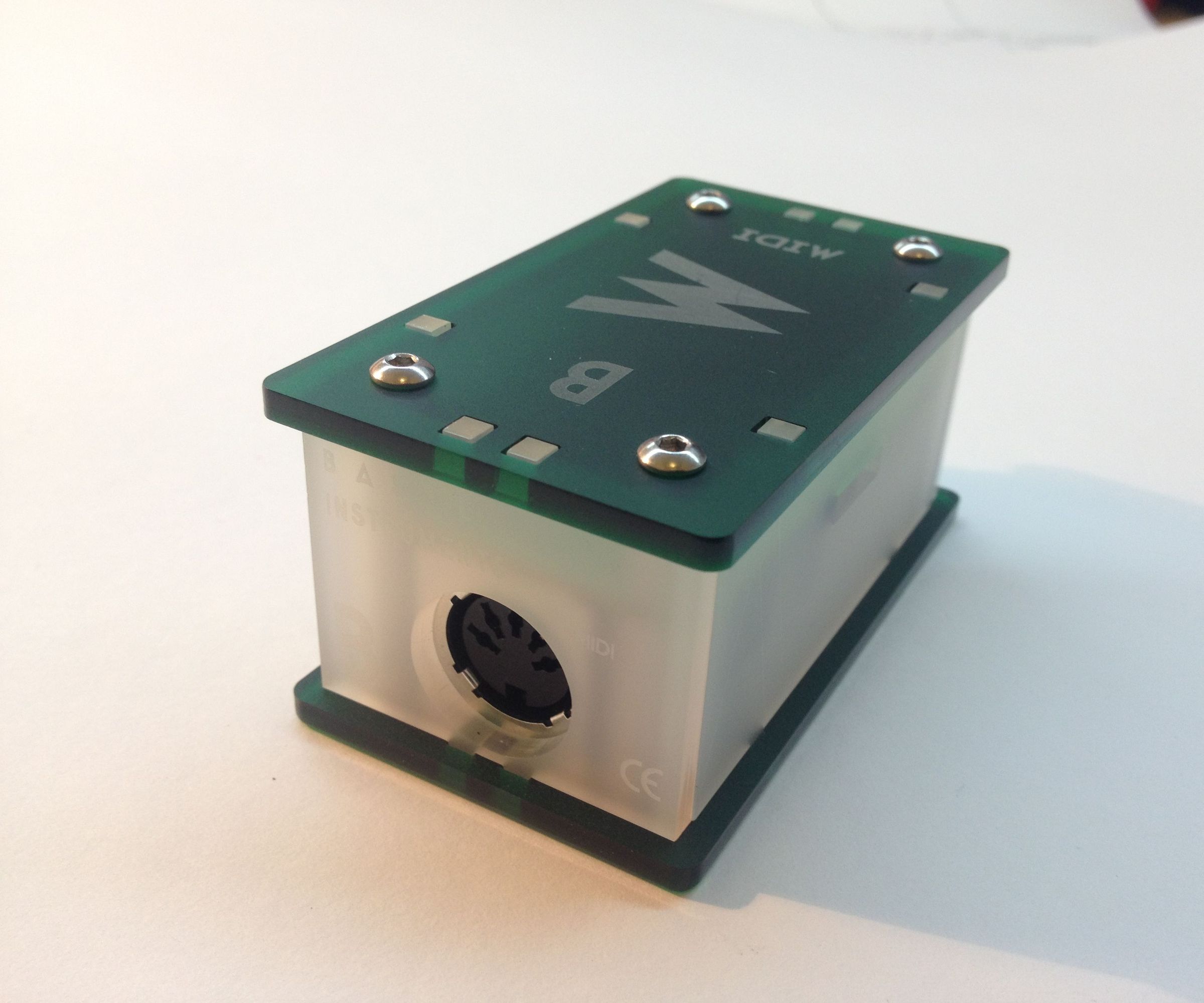

Step 1: Midi Connector
First, you have to solder Midi connector for output to the PCB.
If you are modding your already assembled MidiBastl, you have to remove audio jack first. Desolder it, or be destructive and cut/crush it out with pliers.
There's a small hitch: connector you are about to solder does not fit onto board, because there is extra plastic leg in the middle, exactly where socket for Attiny is already placed. So grab those pliers and get rid of it!
Now put it in place and solder it onto board.
