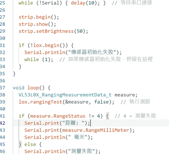

Step 3: Program
Creating a Responsive LED System with VL53L0X Sensor and NeoPixel Ring
This project demonstrates how to use an Arduino to control a NeoPixel LED ring based on distance measurements taken by a VL53L0X sensor. The system is designed to change the color of the LEDs based on an object's distance and includes a feature to flash the LEDs red at specific intervals.

3. Setup Function
cpp
void setup() {
Serial.begin(115200);
while (!Serial) { delay(10); }
strip.begin();
strip.show();
strip.setBrightness(50);
if (!lox.begin()) {
Serial.println("Sensor initialization failed");
while (1);
In setup(), the serial communication and NeoPixel strip are initialized, and the VL53L0X sensor is started. If the sensor fails to initialize, the program stops.
4. Main Loop
cpp
void loop() {
VL53L0X_RangingMeasurementData_t measure;
lox.rangingTest(&measure, false);
if (measure.RangeStatus != 4) {
Serial.print("Distance: ");
Serial.print(measure.RangeMilliMeter);
Serial.println(" mm");
} else {
Serial.println("Measurement failed");
unsigned long currentMillis = millis();
bool currentMilkIsOnBorad = (measure.RangeMilliMeter >= 75 && measure.RangeMilliMeter <= 90);
if (currentMilkIsOnBorad != previousMilkIsOnBorad) {
stateChangeMillis = currentMillis;
} else if (currentMillis - stateChangeMillis >= STATE_CHANGE_DELAY) {
milkIsOnBorad = currentMilkIsOnBorad;
previousMilkIsOnBorad = currentMilkIsOnBorad;
if (milkIsOnBorad) {
if (!isFlashingRed && (currentMillis - previousMillis >= RED_FLASH_INTERVAL)) {
previousMillis = currentMillis;
isFlashingRed = true;
flashStep = 0;
if (isFlashingRed) {
flashRedNonBlocking(currentMillis);
} else {
rainbowCycleStep();
} else {
isFlashingRed = false;
setRingColor(strip.Color(255, 255, 0));
The main loop continuously measures the distance and determines if the object is within the specified range. If the distance remains stable for 0.3 seconds, the system updates its state and changes the LED color accordingly.
