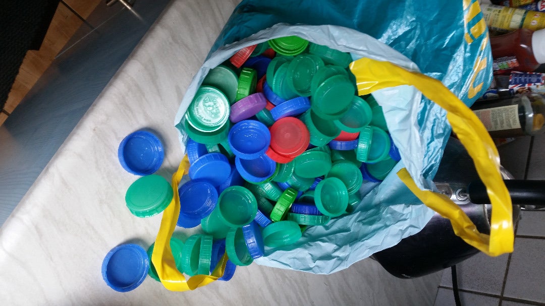

To start off with you need LOTS, just to be clear here LOTS of milk bottle/coke/fabricsoftner tops I get various places like cafes, staff canteens an family to save them for me just ask whoever you can.

This is a really important step if you don't want material that smells of old milk and this is also a good time to remove any of the little silver seals stuck in the lids.

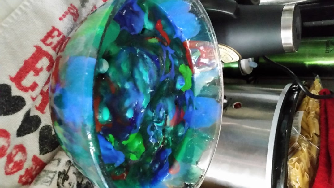

Fill you mold with the caps and back as hot as you can. The lids are HDPE which is a recyclable thermoplastic (can be heated and reshaped) which softens at about 120 Celsius but we want to go as molten as possible so high heat (I was at the 220c mark) these will liquify for lack of a better word and sink to the bottom so keep topping up with caps till you reach your desired fill level, at this point if your very well equipt stick it in your vacuum chamber to get the air out but alas is don't so i must suffer air pockets in my work (its good you sell them and proof of fully hand made recycled item) now switch the oven off and let the blank cool slowly in there to stop it warping this will take 8 hours plus if its a large blank.

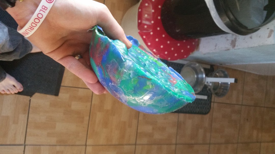

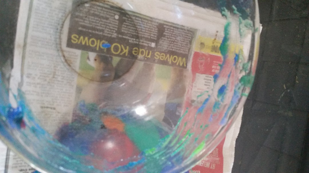

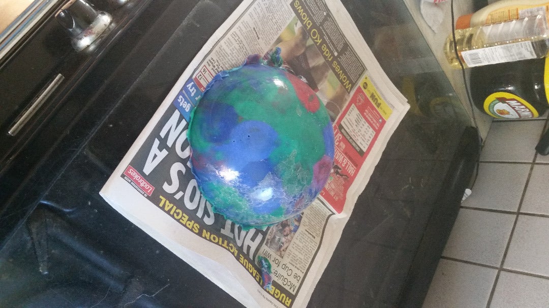

this was a gamble as i usually do this in loaf tine paper cases so the just lift out but this time i decided to see if glass would keep it loose, it didn't until i stuck it in the oven at 200 for 5 minutes then up ended it which should work on all smooth molds? but wont leave the mold completely clear. this can be remidied if really needed with more heat just burn it out after scraping any big bits off the hot surface.

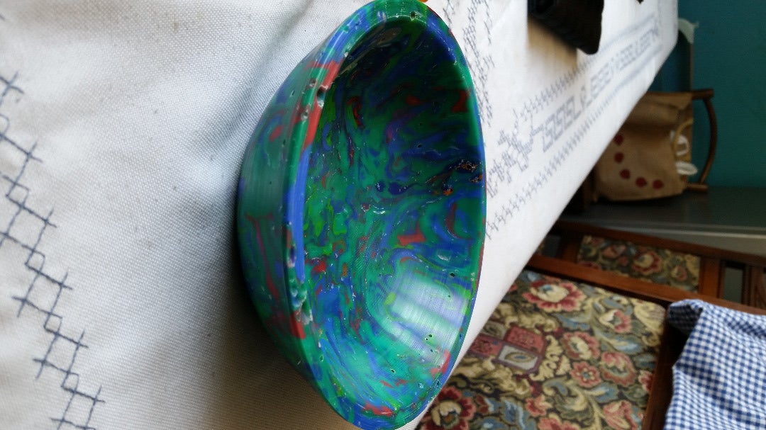

Whatever you want to i've done pens, bottle stops, garden dibbers and now a cereal bowl.
This isn't a wood turning tutorial (i can do one at some point if its wanted) but I will take anyone interested through my process (everyone works differently especially with turning)
I mount the blank between head tail stock as centered as I can by eye (brilliant tool impossible to buy a new one even from screwfix so put a protective case on yours such as goggles) and then make it true round from said centers and the shape i want before cutting a rebated dovetail in the base for my chuck jaws to expand into and grip.
clean the base as you wont have it spinning at 2000rpm and accesable at the same time after this.
spin the blank round and grip with the jaws and turn out the center which ever method you prefer as the all work on plastic do a clean pass on the outside and the rim aswell and make it all nice and clean and then out have a bowl.
