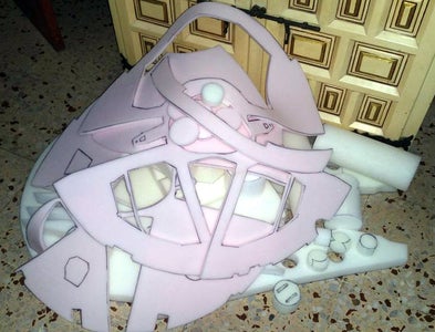

Once I has the correct measures for my Falcon, I divided the design in pieces. At the place where I ordered the rubber foam, there were certain limitation with what they could do so I designed my pieces having this is mind. Basically you can order a profile cut of a piece of any thickness you want but the can't make cuts that are not perpendicular to the surface of the piece. So things like the cockpit or the docking bays that are truncated cones can't be ordered so in this cases I ordered cylinders and then I would have to form the cones by hand.
I needed to provide them with cutting templates for the pieces so I composed all of them in a 1.2 x 2.2 m canvas and printed it in banner fabric in a plotter. Banner fabric is not easy to deform, it is vinyl coated and it does not tear apart.
I cut all the templates, each one with an indication of the thickness of the piece (I also grouped them by colours) and took them to the rubber foam factory.

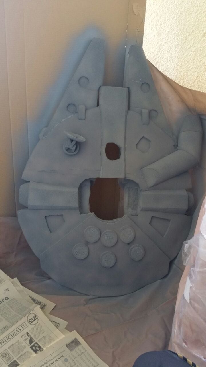

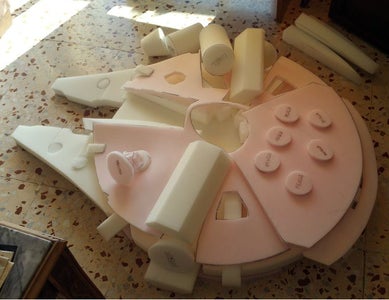

Back in home with all the pieces I made a fast composition with them. Things looked good. Notice I didn't create the central part with the blaster turrets because this part was going to be replaced with the tricycle seat.
I finished some pieces by hand using scissors, specifically the cockpit, the two side docking bays and the cuts of the neck that leads to the cockpit. I also had to bezel the upper and lower jaws. I didn't ordered them like the pier pieces (the hexagonal features that lead to the docking ports) because they don't have a constant width. I also cut a tiny piece for the center of the antenna and two pieces for the sides between the jaws and the saucer that can be seen in the last picture.
I then glued all the pieces together using contact glue (the glue used for shoe repair and carpeting). You have to aply it using a palette knife on both surfaces and wait a couple of minutes before joining the pieces. Don't apply any pressure because then the glue will soak the foam and deform it. Just join the pieces and they will bind as one.
Step 5: She May Not Look Like Much, But She's Got It Where It Counts, Kid
I then removed the seat and the handlebar from the tricycle and fitted the Falcon on it. I measured the foam I needed to cut in order to accommodate the seat in and made a hole to fit the handlebar.
I cut some circles of window mesh and glued them on the circles over the engines. You can add surface details at your will but I decided to make the rest with the paint job.
Then I spray painted the Falcon all with grey and also the seat and handlebar. Using white and black acrylic paint I painted all the panels and details of the surface. I also used the paint very diluted to enhance the borders in white and the recesses in black. I used a red marker for some of the panels.
