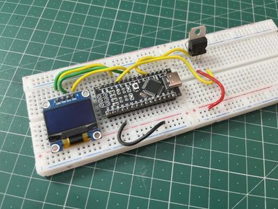

we will use the same Ohms law to calculate the resistor in milliohms. We have to measure the resistance, by keeping the current constant and measuring the voltage drop finally gives the value of unknown resistance.
To make a supply with constant current here I am using LM317 regulator ic which has a reference voltage of 1.25. You can see the constant current configuration of this IC in datasheet.
Step 3: Circuit Diagram:
The screen uses a 4 wire I2C interface with Arduino, 2 wires for the power and 2 for the data. Arduino Nano is required to drive the display panel and to do ohm’s law calculations. We are using a 10ohms resistor between adjust and output pin of the LM317 which gives the current limit of 0.125 amperes. A battery of 9v is required to power the circuit.
By keeping the current constant at 0.125 amperes and measuring the drop across the unknown resistance. The value goes to ADC of Arduino which then converted into voltage and divided by current. By this method we can measure the small resistance values.

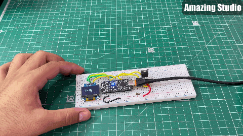

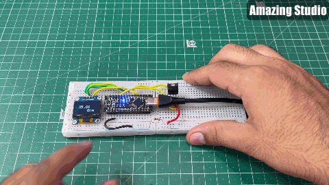

Step 6: Demonstration:
After making all the connection I do a test on the breadboard and the circuit is working well. Now it is very easy to measure the small resistors like shunt with more precision. And it can be also used to measure the wirelength using resistor measuring. We will come with a similar project soon.
