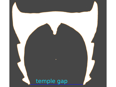

Measure your temple gap - the straight line distance between your temples as shown in the picture.
The default size of the Bone Crest (temple gap) is 137 mm.
If the size is really off - to the point where it cannot be adjusted with the foam padding, i.e. more than 10 mm bigger than your temple gap, or if you really want it to fit tightly, use the fitting rings 3D models provided. Print them and see which one fits your head best.
There are 3 rings provided - small (116 mm), medium (130 mm), and large (142 mm).
Find the ring that gets stuck on your head and the one that goes freely on and off. Note their temple gap sizes.
