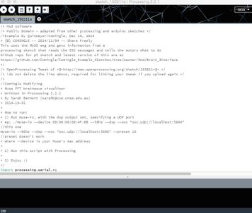

Step 1: Load Arduino Sketch
To utilize the Muse Brain Sensing Headband with your [ROBOT], first send the code below from Codebender to your personal massager by selecting "Run on Arduino." It's that easy! Thanks Codebender!

Step 3: Run Processing
Next, just download our code* from the link below Ohinto the processing application and hit run.
https://github.com/Comingle/Comingle_Example_Sketches/tree/master/Mod/Brain_Interface/P5_Muse_EEG_MultiControl

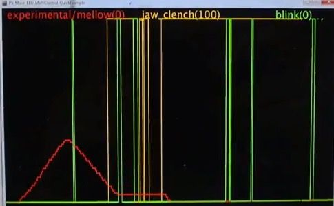

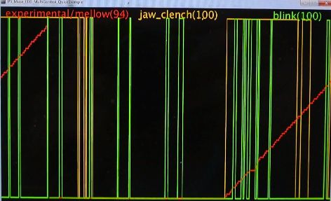

Mood Sensing, Eye Blinks, and Jaw Clench
Connecting the Muse Headband with Bluetooth allows for new [FUN] play and experimentation with the Mod! Control your Mod's vibrational pattern by either blinking your eyes, clenching your jaw, or perhaps simultaneously do both! You may also find a fascinating challenge when trying to control your [GOOFY OL ROBOT] with your given mood. Currently, we have written the code to respond to one's mellow mood versus their excited mood. Even we had a little trouble controlling our Mod's vibe because of how excited we were about this new cool, and fun development!
