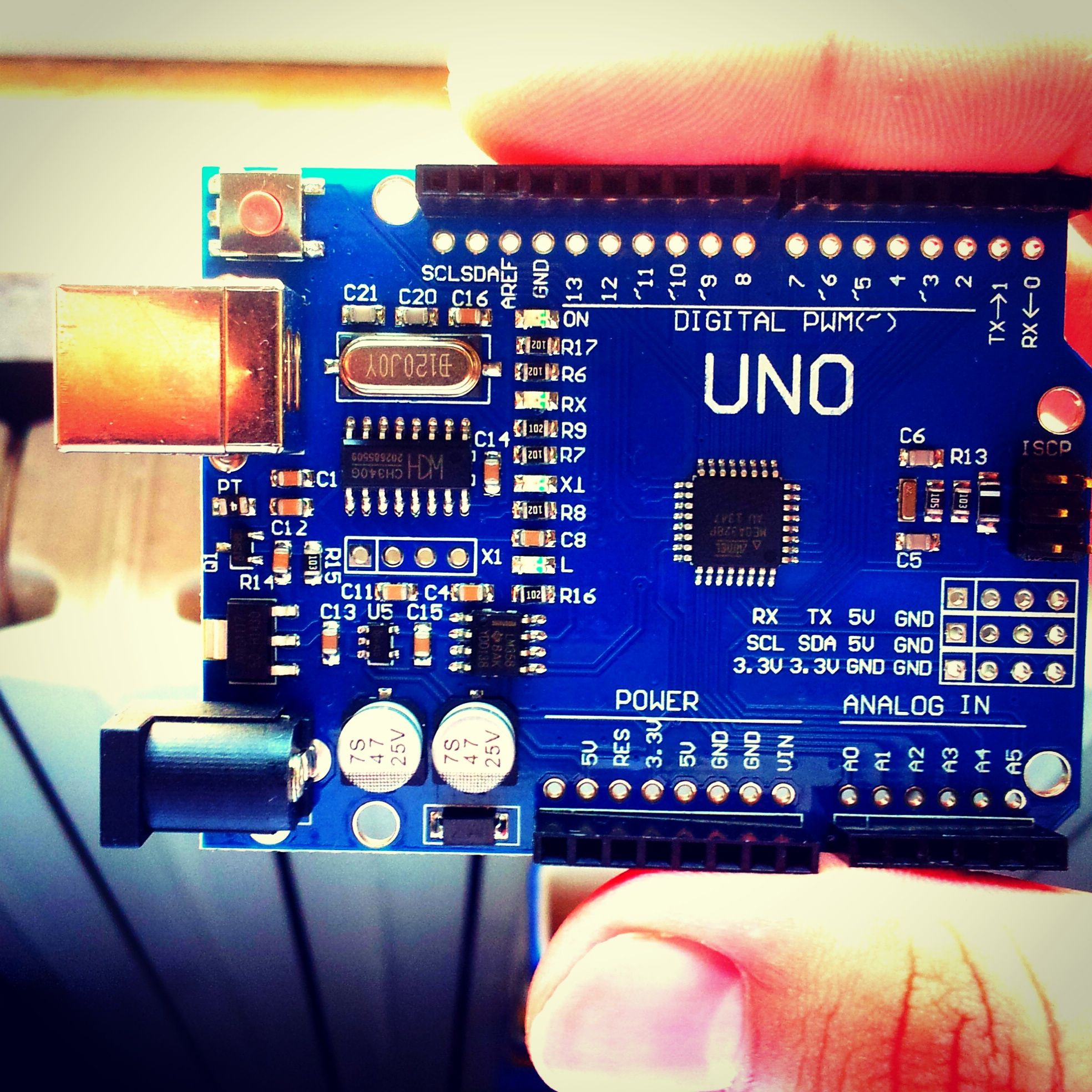

- 1 Arduino UNO R3

The circuit is a standard traffic light circuit.You have to connet a GND pin of the Arduino to the negative rail of the Breadboard (Sorry,i forgot to connect the rail to the arduino GND on the scheme).Then,you have to connect the anode (Long Leg) of the green LED to the Arduino pin 2, the anode of the yellow LED to the Arduino pin 4 and the anode of the red LED to the Arduino pin 7 (But you can also use the PWM pins).Done this,you have to connect the cathode (Short Leg) of the three LEDs to the ground rail using the three resistors.
After this,you have to connect the ground wire of the MindFlex to the Arduino ground,and the " T " wire to the arduino 0 (RX) pin.
Now you have to upload the code (remove the wire connected to the RX pin first,and reconnect it after the code is uploaded,because the Arduino IDE can show an error).
