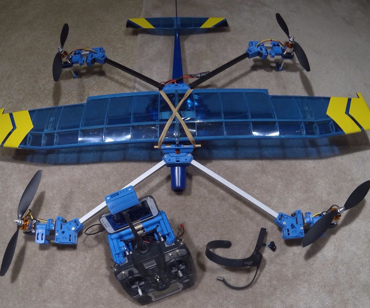

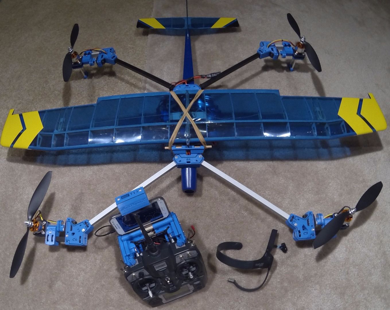

The controller backpack is a frame for holding a Arduino board, smart device, two servos with a battery. There are fourteen different 3d printed pieces making up the controller backpack. The backpack function is for input for the transition between hovering and flying on RC model.
-Two ways for transition-
Using the spring loaded trainer switch on controller, a person may toggle between a manual or mind input. On left side of controller is a shift lever to use with index finger for manual input, through the printed gearing.
The other input uses a Mindwave EEG reader, and is bluetooth to a smart device. The app on smart device puts out an audio tone when, the Mindwave reads a meditative state. An Arduino board on controller turns a mounted servo when the audio tone is recieved. The servo then turns a input knob on controller, through a different set of printed gearing.
