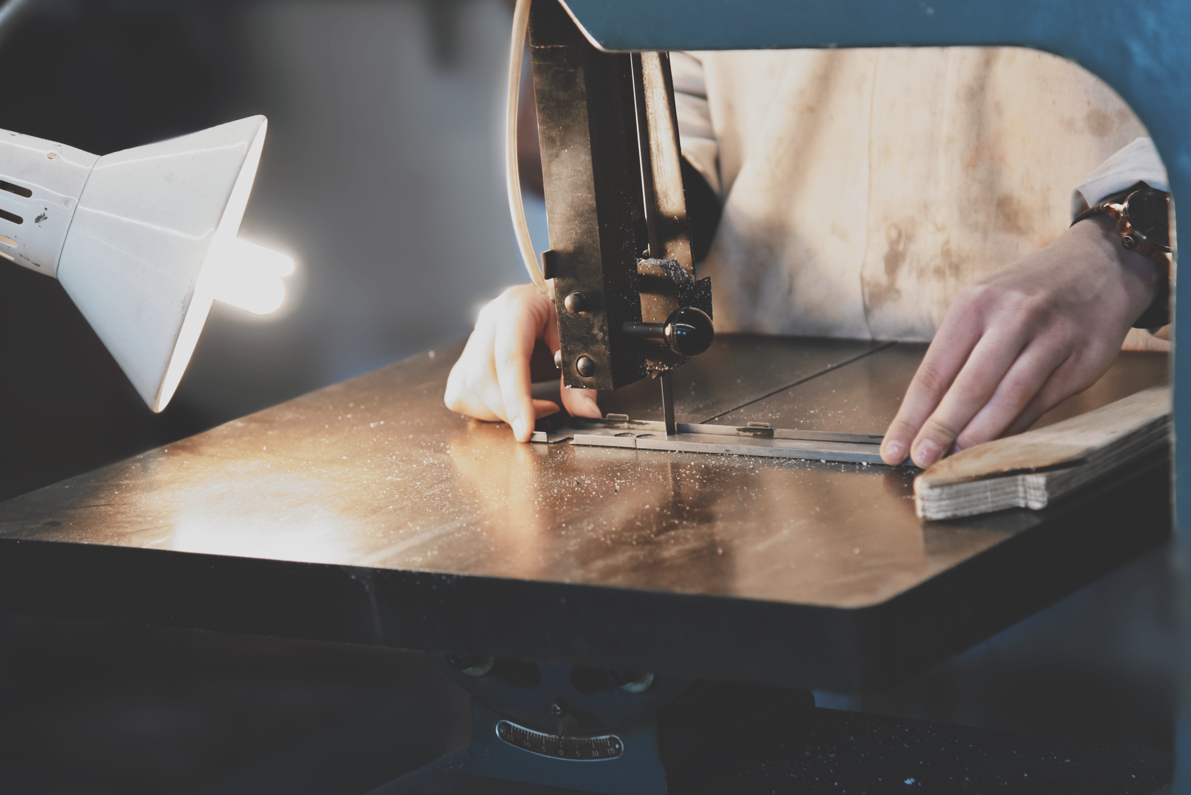

Step 8: Building: Mark and Cut Your Pieces
Mark your pieces with dimensions provided in step 3 & 4 prior to cutting.
Various tools and machines were utilised here; pliers, band-saw and a dremel was used.
