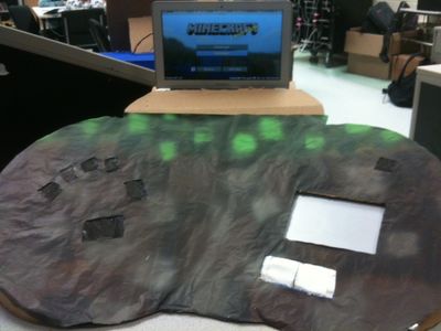

I made a Minecraft controller that plugs into the computer to control game.

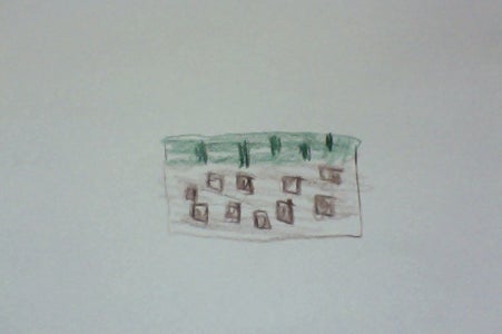

Step 2: Step 1:
Draw your circuit. Make sure to include a route for your ground or earth circuit, too.

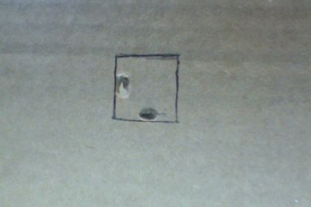

Step 8: Step 1:
Draw a one inch square box on your cardboard controller surface where you want your button go.
Step 9: Step 2:
Put two holes inside the box on sides that are perpendicular to each other.

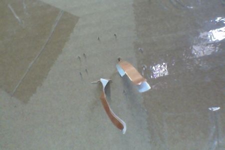

Step 10: Step 3:
Put a one inch piece of copper tape through each hole, leaving some hanging through the back side of the hole. Put one side through sticky-side up and the other through sticky-side down.
Step 11: Step 4:
Cut out a paper square that is slightly larger than the box you drew on the cardboard.
Step 12: Step 5:
Stick the paper square to the pice of copper tape that is stick-side up
Step 13: Step 6:
Then bend the paper slightly and use hot glue or staples to attach it over the top of the copper pieces making sure that the copper pieces aren't touching each other unless you push on the button.
Step 14: Step 7:
Attach the key-bound and earth wires from the MaKey MaKey (or your circuit board), one to each piece of tape.

Step 16: Making the Themed Skin
This next section is about making the the skin which goes on the controller to theme it to your game.
Step 17: Step 1:
After you complete your buttons and box, measure out a large piece of paper from a roll. Make sure it's big enough to completely conniver the top of your controller.
Step 18: Step 2:
Design how you want your box to look color-wise.
Step 19: Step 3:
Paint the paper to match your design.
Step 20: Step 4:
Use paint dots around your buttons to create an outline on the back of your paper so you can cut out spaces for the buttons.
Step 21: Step 5:
Cut out spaces for the buttons.
Step 22: Step 6:
Attach your skin to your controller with hot glue. Make sure that you glue it well around the buttons and edges  to prevent tearing.
