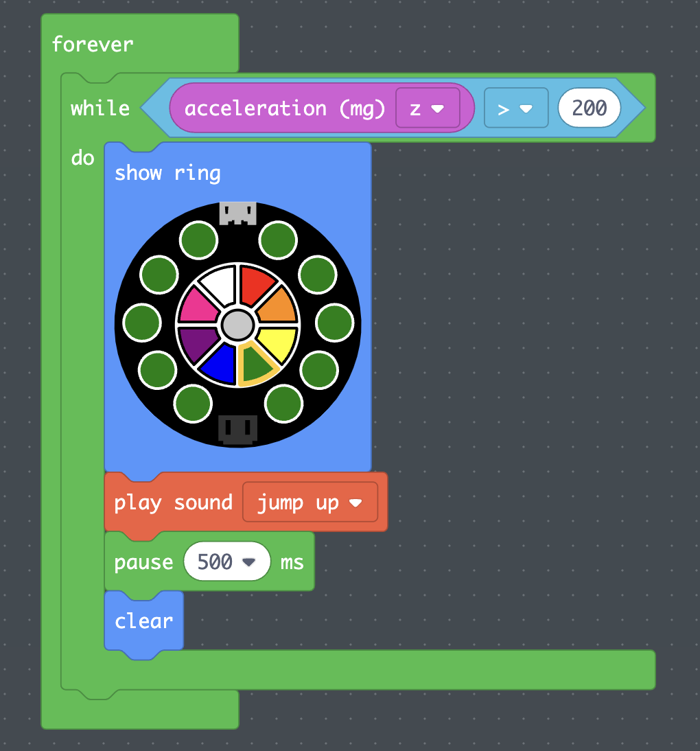

Step 7: Making the Light-up Code
The CPX inside the creeper serves to light up and make noise when the toy is shaken.
Open https://makecode.adafruit.com/ and create a new project. the photo of the code is attached.
You can change the sound and color of the CPX activity - mine lights up green and makes a noise when it is shaken.
