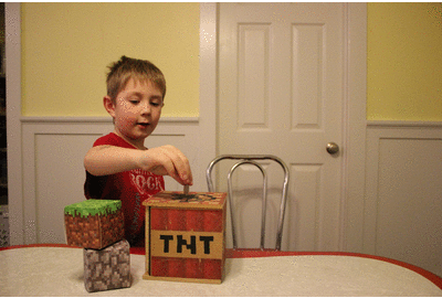

Introduction: Minecraft Exploding TNT Prank Bank (Wood Printer Image Transfer)
This Minecraft TNT bank "explodes" when you put money in it. This is a fun project that can easily be completed in a few hours with very basic tools and supplies.

Step 7: Finished! Ready for a Test Run!
To use the bank, arm the mousetrap, and then assemble the sides and place it on the mouse trap base (I found that assembling the sides off of the base and then moving it to the base works better, otherwise it's easy to accidentally set off the mousetrap from bumping the base when putting the sides together). Make sure to place the 2 nails on the side and front where the arm of the mouse trap will grab them. Then place the lid with the coin slot on the back where the mousetrap activator is. Now you just have to find someone to put some money in the bank :)
Here is the video again of it working in case you missed it before:
