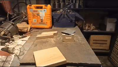

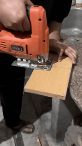

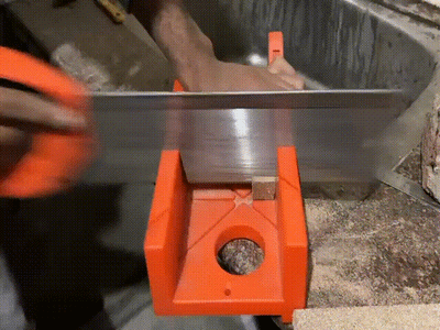

Step 1: Cutting the Wooden Parts
To create the lamp’s structure, we need the following wooden pieces (1-inch thick):
- Two 13x13 cm pieces (for the top and bottom parts of the lamp)
- Two 9x9 cm pieces (for the front and back sides)
- Four pillar pieces of 12 cm length (to hold the frame together)
- One grab handle piece of 9cm length and 6 cm height, with a groove cut inside it (to resemble the handle of a traditional lamp)
Using an electric saw, carefully cut these wooden parts, making sure the dimensions are precise to ensure a proper fit during assembly.

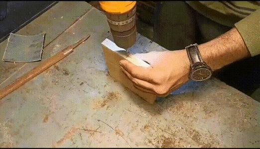

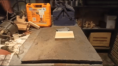

Step 2: Sanding the Wooden Parts
Once all the pieces are cut, use sandpaper to smooth the edges and surfaces. This step is important to:
- Remove any rough or splintered areas.
- Ensure a polished finish before painting.
- Improve the adhesion of paint and varnish later.

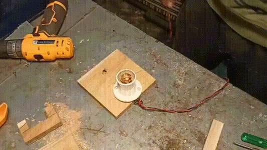

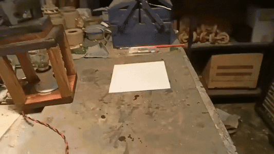

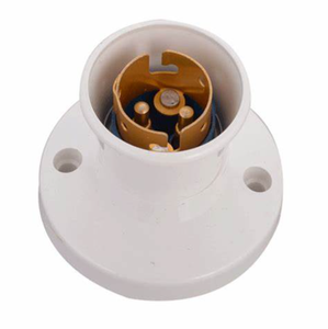

Step 3: Installing the Bulb and Holder
- Attach the bulb holder to the center of the baseboard (bottom 13x13 cm piece).
- Drill a hole in the baseboard to allow the electrical wire to pass through neatly. This prevents visible wires from disrupting the aesthetic of the lamp.

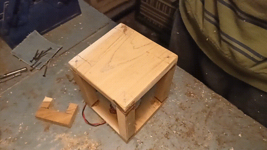

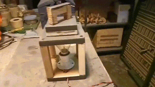

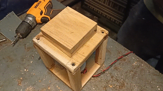

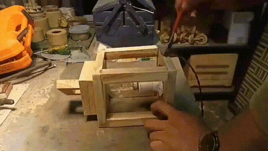

Step 4: Assembling the Wooden Frame
Now, assemble the frame by attaching the pillars to the baseboard:
- First, stick the pieces together using superglue to hold them in place.
- Once aligned properly, drill holes and secure them with 1.5-inch wood screws.
- Attach the top 13x13 cm piece to the pillars, completing the basic wooden frame.
- Finally, attach the 9x9 cm pieces to the top of 13x13 top.
- The handle piece is placed on top, aligning with the lamp's aesthetic.

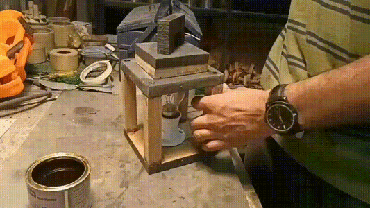

Step 6: Painting and Varnishing
- Apply grey paint to the wooden frame to match the original Minecraft lamp’s metallic look.
- I've not painted the brown part as I liked the natural color of this wood I'm using.
- Once the paint is dry, apply a coat of varnish to protect the surface and give it a polished, finished look.

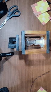

Step 8: Attaching the Panels
- Use glue or adhesive to fix the sunboard panels onto the wooden frame securely.
- Ensure that the printed design aligns properly to maintain the Minecraft aesthetic.
- I’ve attached the parts by pasting them with superglue, as I didn’t have anything else at the time. However, you should attach it in such a way that you can open it whenever you want. In my case, the back panel is the only one that can be opened for maintenance.
