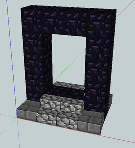

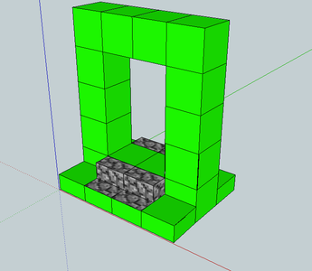

Step 2: Planning
I used Google Sketchup to plan out what I would do. This allows you to easily keep track of what you'll be doing.
You can download the model for this project here. Feel free to use it however you wish.
The reason why I used this was because as I went along and made each piece for the dock, I painted each section green to show what I've done and what needs to be done. See the pictures below, and you'll better understand what I mean:

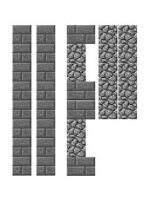

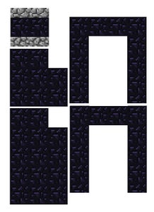

Step 5: Print Out Textures
Download the images below. At their original resolutions, they should print in 1-inch squares.
Print them at about 110% just to be safe. Doing so will give you just enough room to cut it more in case they don't fit exactly on the model.
Paste the textures onto the dock as you see in the model with any adhesive of your choice.
