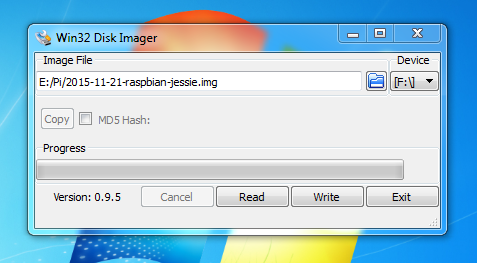

Then, insert your MicroSD card and open Win32Disk Imager.
Click on the blue folder and navigate to the file you put the Raspian image in. Click on the Image.
On the device tab, make sure you have the correct card selected, the click write.

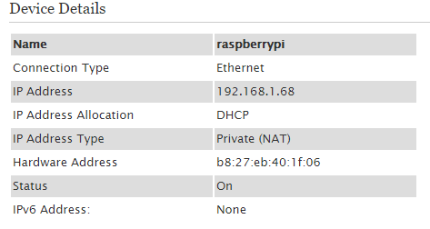

Write down or copy your default gateway, then put it in your browsers URL box.
This should take you to your router, every service provider is different, but there should be a section for devices.
Find the device named raspberrypi and the Pi's IP should be right there.

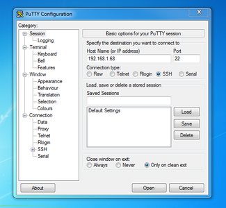

In order to access your Pi' headless, you need to use Putty.
Open Putty
Under host name, add the Pi's IP you found earlier. Make sure SSH is selected and the port is 22.
Click open
And you're in! It may give you a warning, this is normal, just click Ok.
The username is pi and the password is raspberry

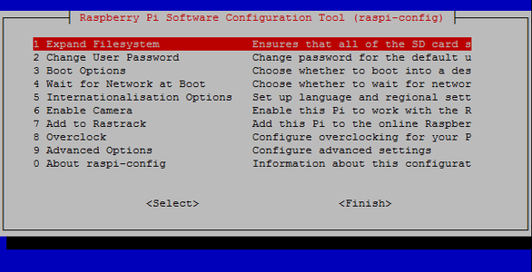

Settings: We are going to need to re-size the SD card in order to make sure we have enough room to install the .jar file to run the server:
sudo raspi-config
This will open up the config menu. Find Expand Filesystem. Hit enter. Finish. Then reboot.

Now, once all of this is completed go to the config panel and set overclock to high. (This is to prevent lag, and I highly recommend getting a case with a fan for your Pi, such as this.) Finish and reboot.
