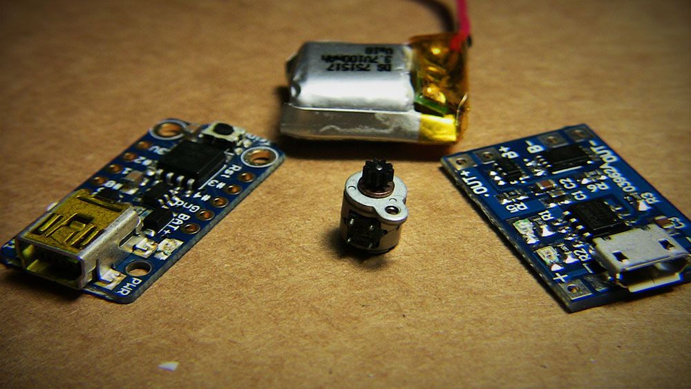

On the hardware side, there are a few parts that you will need to build the watch:
- Adafruit 3.3v Trinket
- 3.7v LiPo Battery
- USB LiPo Battery Charger
- Mini Stepper Motor (Alternate Option)
- Mini Switch
- Sun/Moon graphic
- 3D printed case
- Soldering/Hot Glue equipment
Total Cost: Approx $20

Now that we have are parts, the first thing to do is connect the stepper motor to the Adafruit Trinket. In pretty much every other situation when you are dealing with stepper motors, you will need a stepper motor driver. However, since our stepper motor is extremely tiny and requires very little power, in this rare instance, it can be driven directly by the Trinket.
Your stepper motor should have four output terminals, and depending on the motor you've purchased, those terminals may be different than mine. As you can see in the diagram above, the two top terminals connect one coil, and the two bottom terminals connect the other one. If you are unsure how your stepper is connected, you can use a multimeter to see which ones pass current.
Once you have your terminals established, you can connect it to the Trinket as layed out in the diagram above. The first coil set connects to pins #3 and #1 on the Trinket, while the remaining coil set connects to pins #0 and #4.
With the motor connected, we can now load up the software. The Arduino code is extremely simple. Essentially, you set up a class for the stepper motor, and then tell it how man times you want it to move per second. As a demonstration, I just set mine to delay for 1,000ms or 1 second so that each tic was easily visible. If you want to to be more accurate to day/night revolutions, you can set it to 300,000ms, which is 50 minutes (I didn't use 60 minutes, because the stepper only has 20 steps to make a full revolution). Here is a copy of my code (DOWNLOAD IT HERE):
