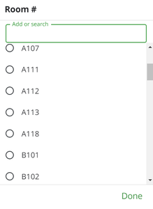

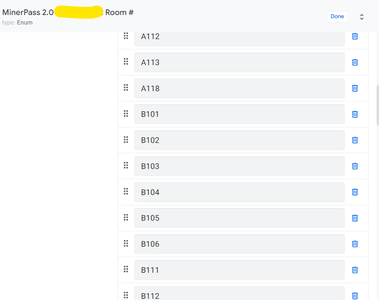

Step 5: Edit Each Enum
Each Enum must be edited so that there are actually different values to be selected from for each column of data. Press the "Edit" button next to the column name. Go to Type Details > Values > Add. Add as many values as you wish. For example, under the column "Type," there is "Test Makeup," "Bathroom," etc. and many other options. You can add as many as you like and whichever options fit your students visitation needs. You'll need to do this for each separate Enum.

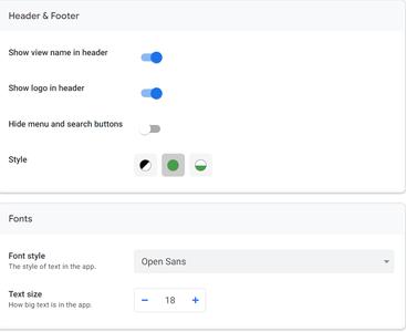

Step 7: Change the Themes and Brand of the App
Go to Settings > Theme and Brand. Go to "Primary Color," select the green, and change the app logo to an image link of the school logo. Do the same for the "Launch Image." Scroll down to "Header & Footer" and toggle "Show view name in header" and "Show logo in header" both on. For "Style," select the middle button (the solid color option). For fonts, I used Open Sans but this is up to preference. Keep the font size at 18.

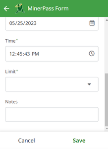

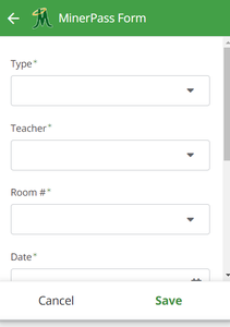

Step 8: Edit the System Generated "Details" and "forms" Under Views

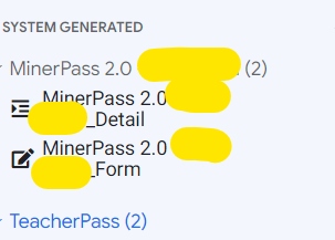

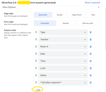

Go to "Views > (under "System Generated") > MinerPass_Form (or similar name) > Column Order. This is where you will adjust the appearance of the forms students will be filling out for their visits / trips. It's important that all the information is in an sensible order. Click "Add" and adhere to the order depicted in the picture, clicking "Add" for each column of data you are adding to the order. Go to Sheet1_Form / TeacherPass_Form (or similar name) under the "TeacherPass" drop-down and do the same to the column order. This will ensure the consistency between the forms.

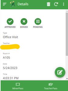

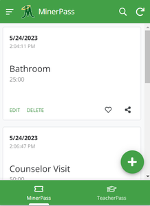

Step 9: Adjust the Primary Navigation Views of MinerPass and TeacherPass

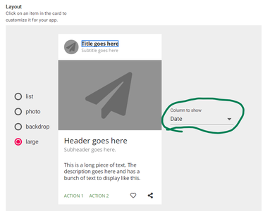

In order to get the desired effect of visuals, first, you'll want to go to "Views" underneath "Data" > View Type > Card. Once "Card" has been selected, scroll down to View Options > Layout > Large. Now, click on "Title Goes Here," > Column to Show (drop-down to the right) and select "Date." Click "Subtitle Goes Here," > Column to Show > "Time." Click "Header Goes Here," > Column to Show > "Type." Click "Subheader Goes Here," > Column to Show > "Limit." Finally, click the "long piece of text" beneath > Column to Show > "Notes." Scroll down to the "Display" section, and change the icon to "ticket."

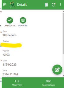

Now, go to TeacherPass. Select "Detail" as the "View Type." Scroll down to "Display" and change the icon to "graduation-cap."
(included are also images of how the style should look and the difference between the "MinerPass" and "TeacherPass" views.)

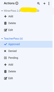

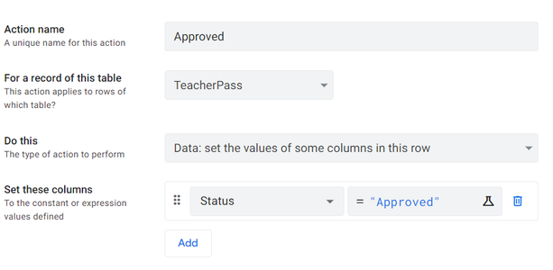

Step 10: Add Actions "Approved," "Denied," and "Pending."

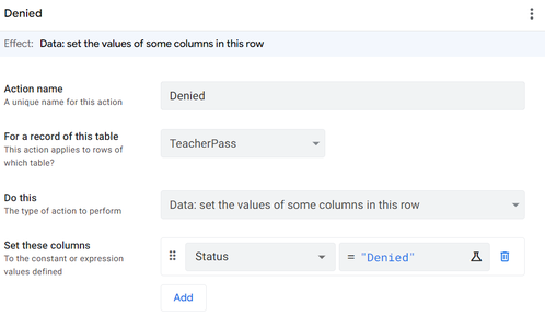

Navigate to Actions (lightning symbol on left side bar). You'll see a list of actions split between the two different tables, MinerPass and TeacherPass. You aren't adding any actions to MinerPass (all you should see under MinerPass is "Add," "Delete," and "Edit"). Hover over the "TeacherPass" drop-down and select the plus button. Select "Create New Action." You will do this three times, one for the Approved, one for the Denied, and one for the Pending action, which all apply to the "Status.

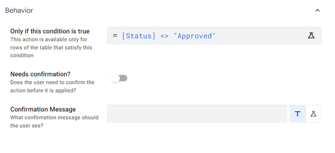

  1. For "Approved," name the action "Approved," make sure it is for the record of "TeacherPass." Navigate to the "Do This" option and the drop-down beside it, and select the option that is "Data: set the values of some columns in this row." Now, you should see the "Set these columns" prompt appear below. Select "Add," then select "Status" as the column. Set the formula to = "Approved". Scroll down to appearance and select "check" for the action icon. Select "Display Prominently" for "Prominence." Under "Behavior," set the "Only if this condition is true" to = [Status] <> "Approved"
  2. For "Denied," name the action "Denied," make sure it is for the record of "TeacherPass." Navigate to the "Do This" option and the drop-down beside it, and select the option that is "Data: set the values of some columns in this row." Now, you should see the "Set these columns" prompt appear below. Select "Add," then select "Status" as the column. Set the formula to = "Denied". Scroll down to appearance and select "times" (x-mark) for the action icon. Select "Display Prominently" for "Prominence." Under "Behavior," set the "Only if this condition is true" to = [Status] <> "Denied"
  3. For "Pending," name the action "Pending," make sure it is for the record of "TeacherPass." Navigate to the "Do This" option and the drop-down beside it, and select the option that is "Data: set the values of some columns in this row." Now, you should see the "Set these columns" prompt appear below. Select "Add," then select "Status" as the column. Set the formula to = "Pending". Scroll down to appearance and select "pause" for the action icon. Select "Display Prominently" for "Prominence." Under "Behavior," set the "Only if this condition is true" to = [Status] <> "Pending"

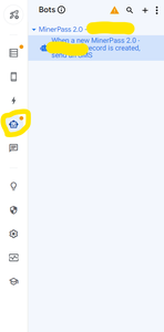

Step 11: Make Email Notification Automation

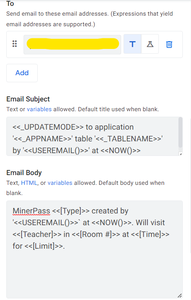

Go the the little bot symbol on the navigation bar on the left side called "Bots," click on it. Click the plus button to "Create a New Bot." Under "When this EVENT occurs," (the cause) select "A new <App Title> record is created." Now, scroll under "Run this PROCESS." This is your effect, or your dependent variable. Type notification into the search bar and select the "Send an SMS option." Now click on this selection and navigate to the settings tab on the right side. Select the "Send an email" card, and "Custom Template" for the "Email Type." Select "MinerPass" for the "Table Name." Under "To," type the email that you want the notifications to be sent to. Multiple automations can be set up for each teacher email with another step to the automation stating "If <teacher name / email> is included," and then routing it to that specific teacher. However, in this case, we route the notifications to one email to keep things decluttered and not spam the teachers when testing the application. Under "Email Subject," type the following (without quotations):
"<<_UPDATEMODE>> to application '<<_APPNAME>>' table '<<_TABLENAME>>' by '<<USEREMAIL()>>' at <<NOW()>>"
Under "Email Body," type the following (without quotations):
"MinerPass <<[Type]>> created by '<<USEREMAIL()>>` at <<NOW()>>. Will visit <<[Teacher]>> in <<[Room #]>> at <<[Time]>> for <<[Limit]>>."
This will form an email that informs the teacher upon creation of a pass of what kind of pass has been by created by which User, at which time, and where they plan to visit, with whom, at what time, and for how long.
