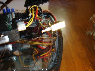

Step 2: Modding the Aquarium
So, your materials are gathered, now to the fun part, modding! (To a certain extent). First, we measured all the dimensions to gain the right aquarium, which just so happened to be a classic 5 gallon one from K-Mart. Tester happened to have a sheet of plexi-glass that was a bit longer than the motherboard, so we used that as the back plate to hold it firmly against the side of the aquarium (plus, it will look like nothing is holding the motherboard at all). We then cut it to size, with the plexi-glass touching the bottom of the aquarium. After that, we took it out and drilled 3 holes in proper holding places so that the motherboard would remain secure. From there, we took the spare plexi glass, and broke it into 4 small 1" X 1" pieces, and glued them together with a bonding liquid that was about the strength between superglue and epoxy. After waiting 10 minutes for it to dry for each layer, we had enough time to take the plastic lid that came with the aquarium to have it serve as a slightly moded bufferzone between air and oil. As shown in the image below, a hacksaw was used to cut the appropriate amount of space for the VGA, RJ-45, keyboard, mouse, etc. to be exposed for connection.

Step 6: Final Thoughts
As of now, it seems to be functioning alright, but keep a couple of things in mind; velcro, as I have found out, does not hold down case fans too well. The one black fan as shown in the images and video started to fall over, but luckily was caught by the other case fan's cord. Phew! One other thing is that the case feels quite hot! Maybe it is because our summers here are pretty warm and humid. I guess certainly no hotter than it was prior in the cirulating air environment. I will certainly keep you posted in the forums about how long this piece of machinery is lasting. I am hoping that if it survives the summer, than it has passed the hardest test on any computer. And by the by, this is one of the heaviest PC's you will ever carry. Since mineral oil is 64 oz. per gallon, and there are 5 gallons plus the weight of the PSU, etc. it should be around 25 pounds. In terms of noise, it would be COMPLETELY silent, if there was no hard drive. Since the hdd is 9 years old, it was not built for silence+performance. Hope you enjoyed this somewhat of a loose tutorial, enjoy the pics and video, and try this on your own if you have computer parts to spare!
Here are some finished product pics.
