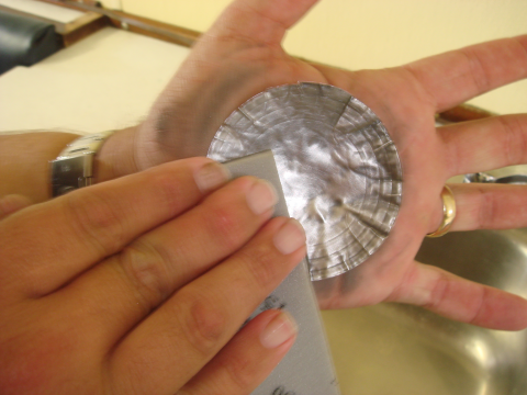

Take the parts that you have cleaned and sand them down be careful with the edges .
If you grip to hard and the metal slips it will cut like a chain saw .see step 10
