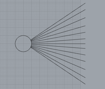

Some issues:
  • Print going out of bounds
    • My first print started at (0,0), so some lines ended up being out of range of the printer. However, the printer is smart enough to not print these off the printer base. Later iterations I changed the location of the curves.
  • Circle curve not extruding
    • Took me a while, but it was because of a few reasons.
      • (1) printer speed too fast when making the circle.
      • (2) After speed adjustments, realizing GCode uses relative values, as any values not specified GCode will just use the previously defined value. Thus, the circle would print at extremely high speed.
      • (3) Needed to extract a bit before actually printing.
      • (4) Needed retraction before moving onto the lines. From the later pictures you can see a line being drawn in the middle of the circle. This is because without retraction, filament got dragged as the nozzle was trying to move. I added a line to retract the filament and this issue was solved.
G0 F9000 X30.00 Y35.00 //Movement to where circle is, notice high speed
G1 F1200 E6.0 ; Extraction //Problem (3) Added line to extract a bit or else nothing will come out of the actual nozzle since just retracted.
G1 F200 Z0.6 //Problem (2) when I did not have the F defined, this line would use F9000, which is too fast for anything to print.
G2 E6.0 I5 J0 //Making circle
G1 F1200 E-6.0 ; Retraction //Problem (4)

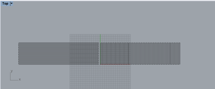

Step 6: Making the Zig Zag Base
Using the Slicer I made earlier that can take in curves, I thought it would be interesting to modify it so that I can create interchanging layers defined by two curve objects to make a base for the hammock.
The first pattern I made was two zig zag curves going opposite directions from each other while stacking.
With the first print, I noticed my code made a prominent diagonal line because of the order curves affected the GCode that was generated. So I stopped that print early on which actually created a cool bendable shape.
I went back to resolve this and printed it for about 15 layers. (No diagonal line)

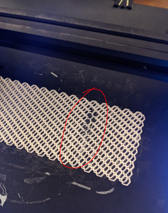

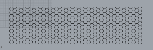

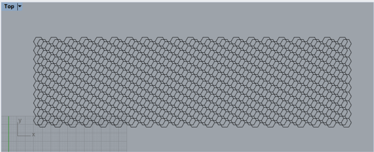

Step 7: Making the Hexagon Base
The previous zig zag base was very strong however a bit boring. I saw a hexagon pattern online that layered on each other so I decided to change the curves to make a hexagon tile. I couldn't make everything into one curve but I hoped it would be fine as I just changed the code to loop through curves instead.
But it kinda killed my computer :( It took almost 2 minutes to calculate the entire GCode output for 15 layers. I just hoped for the best and printed it but I see some issues. But I don't think my computer is a great state to debug it at the moment, so just letting it be.
A very noticable issue that you can see from the GCode visualization and actual print is that the path generated is not optimal. Curves are printed that are not close to each other, causing some artifacts. You can see this through the resulting hole in the print. I think I also messed up the retraction somewhere, further worsening the hole in the print.
