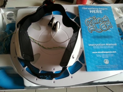

1 Mind Flex  EEG Headband -To monitor Brain Wave signals as described Here I recomend you review this project before starting to build this instructable. You will need to download the brain library found in the website

Step 4: Phase 1: EEG Monitor (Hardware)
As I mentioned before,I  will be Developing this project in various phases because  I'm not quite sure how it will all come together yet, and whether the Arduino will be able to handle it all.
So lets start with the EEG Monitor:
Before attempting to start this phase, I recommend you visit the  Frontier Nerds web site, Where they do a better job than I could, of explaining how to mod the MindFlex headset so you can interface it with the arduino.
You will need to have the Mind Flex headset.
For Purposes of completeness, I will quickly go through the steps I took to hack my headset. Please review the pictures and comments for more detail. (a picture is worth 1000 words).
1.-  Remove the 4 screws from the back cover of the left pod of the Mind Flex headset.(The right pod holds the batteries.)
2.- Open the case to expose the electronics.
3.- Identify the  NeuroSky Board.It is the small daughterboard towards the bottom of the left pod.
4.- If you look closely, you will see pins that are labeled T and R  — these are the pins the EEG board uses to communicate serially to the microcontroller on the main circuit board.
5.- Solder a length of wire (carefully) to the “T” pin.  I used a pair of wires that  came from an old  PC. Be careful not to short the         neighboring pins.
6.- Solder another length of wire to ground using the large solder pad where the battery’s ground connection is.
7. - Drill a hole in the case for the two wires to poke through after the case was closed.
8 .- Guide the wires through the hole, and recheck your soldering.  I recommend putting a dab of glue in the hole to secure the         wires in place ( I used my hot glue gun to do this).
9.- Carefully put the back case back on and re secure the screws.
10.- Connect the Mind Flex to the Arduino; Connect the Wire coming from the T pin to the Arduino rx pin,  Connect the other wire to an arduino GND pin.
