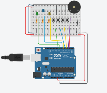

Step 3: Wiring

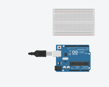

  1. Begin by connecting the breadboard to the Arduino Uno by wiring both a power wire and a ground wire between the two.
  2. Wire both a ground and power wire from the bottom of the breadboard to the top of the breadboard.

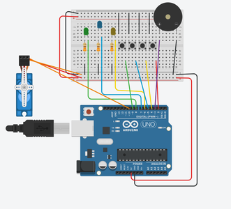

  3. Wire the Servo motor by wiring both a ground and power wire from the Servo to the breadboard. Then wire the signal port from the Servo to Pin 9 on the Arduino board.

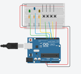

  4. Wire the swing button, with one wire going to ground and the other going to Pin 2 on the Arduino Board.
  5. Wire the 3 Leds, connecting all of their left sides to the ground on the breadboard. Then put a resistor on the right side of each LED. For the Red LED, wire the right side to Pin 7. For the Green LED, wire the right side to Pin 8. For the Yellow LED, wire the right side to Pin 6.
  6. Wire the 3 Buttons, connecting each button's left side to the ground on the breadboard. Then for the Green button, wire its right side to Pin 5. For the Red button, wire its right side to Pin 4. For the Yellow Button, wire its right side to Pin 3
  7. Put the speaker on the breadboard. Positive to pin three, negative to ground.
