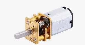

  1. (6x) n20 geared motor. (600RPM)
  2. (6x) sg90s servo motor.

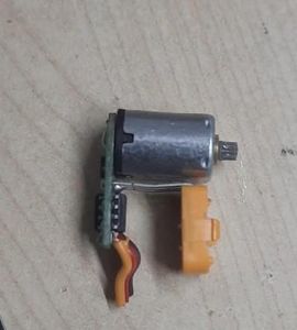

Step 3: Dissemble Servo Motor

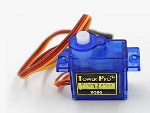

use a screwdriver to open up the servo and remove the gears(do not dispose the gear whose rod is connected to the potentiometer as you will need it in step 7). you should see something like image one. press it on a table downwards until the motor detaches as shown in the image. cut the pin on top part of the potentiometer(the yellow thing). finaly desolder the motor and the potentiometer. you would need to do this process 6 times. DO NOT CUT THE WIRES. locate the + sign on the motor and remember the location. that part will be the "positive" output of the driver.

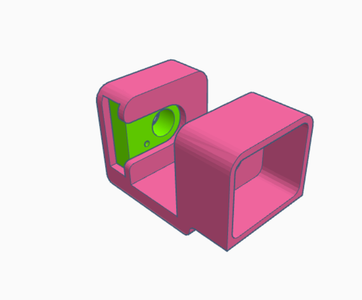

Step 4: Assemble the Joints - 1

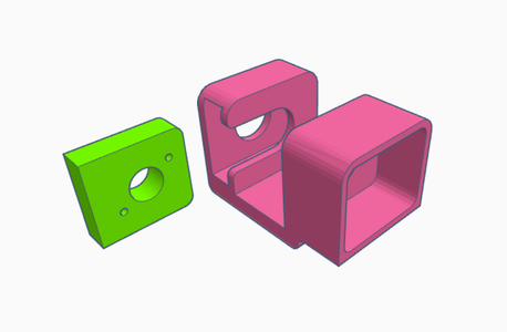

the green part in the image is the potentiometer and the pink part is hip.stl. Make sure that the top part is facing out of the hip or in other words the white disk of the potentiometer should face outwards. you may need to use force to insert the potentiometer. be cautious in this process as you could break the pins.

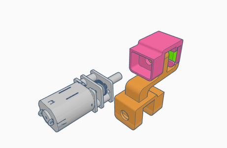

Step 5: Assemble the Joints - 2

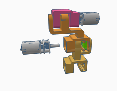

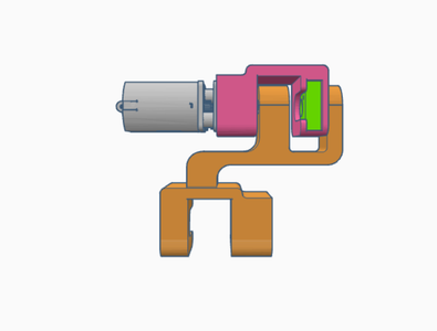

take the assembly in step 3 and arrange it as shown in the image. take n20 geared motor and use pliers to rotate the shaft of the motor in the desired position. place leg1.stl and n20 motor as shown in the image and insert the motor into the slot. you may need to use force (be careful to not widen the hole in leg1stl. do not move the leg around to check if the motor rotates as it widens the hole)

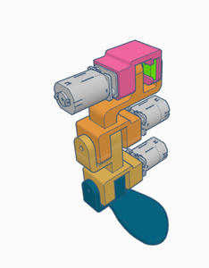

Step 6: Assemble the Joints - 3

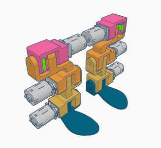

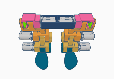

follow this process 2 more times for a leg. as shown in image 2 position leg2.stl, insert the potentiometer keeping in mind that the white disk part should face outwards. insert the n20 motor after adjusting the shaft with pliers. repeat this same process for ankle as shown in image 3. 1 leg is complete. assemble one more following the above directions making sure that the toes face the right direction as shown in image 4 and 5.

with pelvis.stl, use hot glue to attacth the 2 legs to the 3d printed part. the final assembly should look like this.
