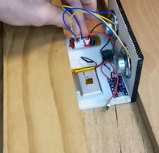

Step 4: Battery Protection Board, Switch and Step Down Module
Now it's time to connect the batteries to the battery protection board. This board will protect your circuit from the batteries in case of short and also allows you to charge the batteries when needed. I also recomment to use male-female connectors for this matter as you can see in picture 1.
Then we need to solder the On/Off switch button to the battery protection board. This switch will act as the main button of the circuit. If it is open (OFF) then no energy flows in the circuit. If it is closed (ON) then we allow energy flow in the circuit and we can connect our device to the speakers to enjoy music.
The step down module plays an important role in this circuit. The arrow in picture 3 shows the direction the energy flows. Solder the switch to the positive side of the step down module and the black wire to the negative side. This is a small screw (picture 5) that you can tighten or loosen the let more or less voltage through the module. We want to feed the bluetooth module with about 5v. Use a multimeter to see how much it is passing through.
Step 5: Bluetooth Module
Now we need to connect the step down module to the bluetooth module. Follow the + and - signs to solder red and black wires as in picture 1. Once it is correctly soldered you just have to insert the male connector into the female connector of the bluetooth module.
Now it's time to check if the circuit is working by turning on the switch. As you can see in picture 2, the blue light is turned on indicating that it works. I decided to fix the circuit to the wooden base with a double sided tape which you can also observe in image 2.

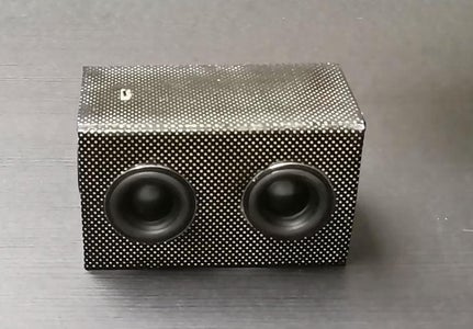

Step 6: Finishing the Enclosure
Let's focus on the enclosure now. We need to cut the solar film with an x-acto knife to be able to insert the speakers in the holes. The enclosure should look like picture number 2.
I used superglue to glue the bass diaphragm to the enclosure. The speakers were inserted under pressure but I also used glue to make sure they stay well fixed. See picture 3 & 4 as examples.

Let's solder the speakers to the connectors that will later on link them to the bluetooth module. In this case you don't have to pay attention to polarity. You can solder the wires to whichever speaker entry you prefer.
The energy flows from the battery to the battery protection board. Once the switch is turned on the energy goes to the step down module and then to the bluetooth module where the speakers were just plugged into. Use picture 2 as a visual help. This is the whole circuit put together.
