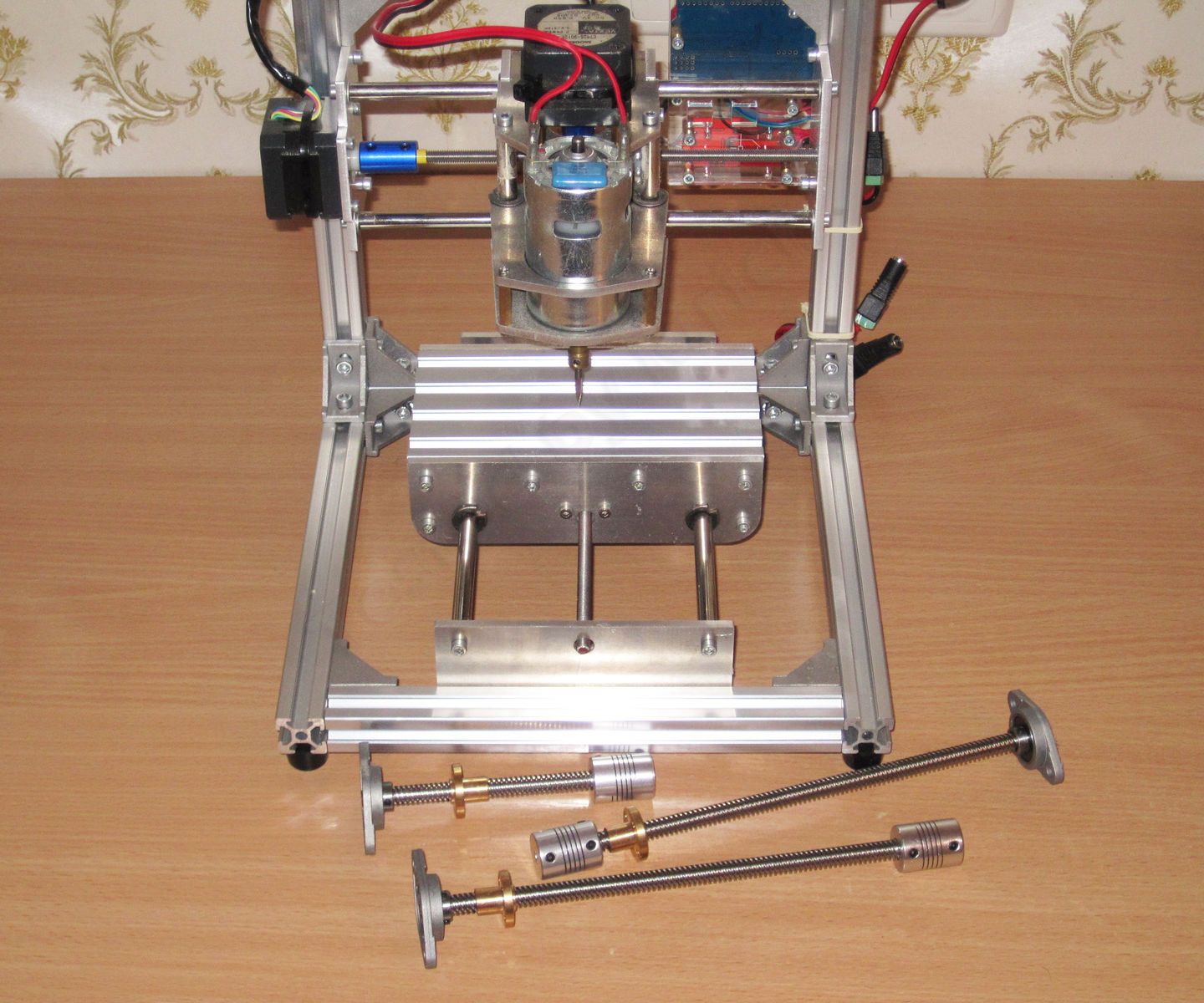

Step 3: Assembling Part 1
The task is to first collect the engraver's chassis.We begin with the bottom part. To do this, take the four aluminum guides and collect them using corners.
Step 4: Assembling Part 2
The next step is to assemble the table that will move on the guides.
To do this, we use the components shown in the photo.
Step 5: Assembling Part 3
In the end, we should get such a strange design. :)
This will be a table moving along one of the axes.

Step 8: Assembling Part 6
Sometimes it can happen that the guide shafts will not reach and you will find that they are too short.
Do not worry, just slide one of the chassis bars so that the length of the shafts is enough for a normal installation.
After that, install the table with the drive shaft and fix it with the motor shaft.Be careful, the shaft should not have beats, careful tuning is necessary.
Step 9: Assembling Part 7
The lower part of the machine is almost ready.
We use three elements of the chassis and mount the upper part of the machine.I was a little mistaken when assembling, the correct position of the mounting elements is shown in the last photo.
It will be available in any version, but in the last version of the installation the working field of the machine will be approximately 20-25 mm larger :)

There are a few more steps left.Assembling the feed unit along the Z axis is the most complex node.
First we assemble the frame, here we also use plastic nuts and silicone washers. To properly set up such a knot, it is necessary to screw two nuts on the running shaft and tighten it so that the shaft is scrolled with a little effort.
Step 11: Assembling Part 9
Stepper motor installation and the last stages of assembly of the displacement unit along the Z axis.
Many steps are similar to the previous ones, therefore I do not think that there will be difficulties.

Before the final milling of the mechanism, the spindle motor must be installed. It also comes complete.
We also mount a mechanism on the spindle shaft to fix the cutter.
Step 14: Assembling Part 12
We got the spindle assembly, install it on the chassis.
Do not forget about rubber feet, they will help your machine not to move spontaneously on the table.
This completes the mechanics of the machine tool.

Hi pretty nice guide:) 2 months ago i had to help one of my friend to assembly this kit. Did you put on any endstops? or this machine don't need them(like the 3d printers)?
Reply 5 years ago
It don't have any endstops, but defenetly needeng it. I already manage to damage motor coupler by streching it.
