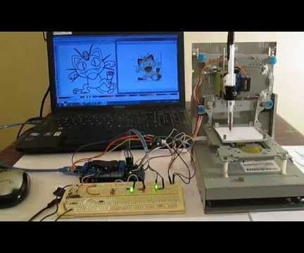

In this project I will show you how to easily build your own low-cost Arduino Mini CNC Plotter!
For X and Y axis we will use stepper motors and rails from two dvd/cd roms! Printing area will be max 4x4cm.

Step 3: X Y Axe
In first image above you will see the Y axis of our CNC machine. Attach it on your surface, in this part you will need some screws and nuts.
In second image you will see the X and Y axis. The X axis is attached to two plastic parts that I took from remaining 'garbage' stuff. I cut it to fit the construction. This is an easy procedure. Just make sure to put the Y axis straight to CNC base and the X axis vertically in this (90 degrees)
Step 4: The Z Axis
That's the most difficult part of our construction.
You will need something to attach it on X axis, a flat surface. On that surface you will attach the servo motor (Z axis) and the pen base. Pen (or pencil) must be able to move up and down with the help of servo motor. Watch the above image to understand what you need to do to duild Z axis. Tip! Use your imagination ;)

I get a red line for the Servo.h lib in the file, and also, GCRTL for Windows doesn't work on windows 10 apparently. It launches, but doesn't take any input from my keyboard. Has anyone else seen this? Can anyone help solve it?

This did not work for me, tried to test x and y axis from gctrl, wont budge, nothing moves. all libraries were installed and code uploaded to the Uno. Thought it might be the motor shield, went and wrote a test stepper motor sketch,shield and the Uno work fine... Pity, looks like a nice little project...

I have uploaded Test_X_Axis_CNC_Plotter and Y, and my engines have good movement.
I have a problem with gctrl.pde and gctrl.exe, but I do not know why. My engines have no movement with gctrl. Select the serial port (OK), use the arrows and no movement, load a gcode image with (G) and no movement. I do not know where the problem is.
You help me? Thank you
