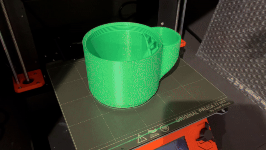

Step 2: 🛠️ 3D Printing the Modules
Use the attached 3mfs (via Printables and Makerworld) for an easier experience!
Print 3–5 planter modules, one bottom base.
  1. Layer Height: 0.2mm
  2. Supports: Modelled in! (via Fusion)
  3. As stated before, be sure you are using a well-calibrated printer capable of handling 0.2mm clearances. "Modern" 3D printers like the Prusa's, Bambulabs', etc are definitely sufficient (I printed all of the parts on the Bambulab A1 Mini and the Prusa i3 MK3s+)
  4. When I created my own prototype, I used the automatic slicer-generated supports. 1 out of 3 of the supports printed successfully (due to lack of proper adhesion). Regardless, the prints still finished and the overhangs turned out okay (with a bit of cleanup)
  5. Use a utility knife (be careful!) and pliers to remove the support
  6. This can get messy if the supports were not printed perfectly!
  7. Infill: 15% gyroid (above 5% should be sufficient)
  8. adjust according to filament supply
  9. Perimeters: (minimum) 2
  10. Time: ~5 hrs/module (for fast printers: ex. Prusa MK4s)
  11. ~9 hrs/module (for slower printers: ex. Prusa i3 MK2)
