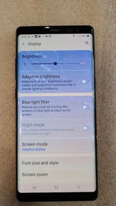

Firstly, the phone should be setup to minimize or preferably eliminate all notifications. So in the settings disable notifications for all apps.
Second, this will likely burn-in the image of the clocks on the display so I chose to reduce the brightness to 1/2 bright.

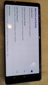

Step 3: Setup Full Kiosk Browser
Run Full Kiosk Browser and open the settings by swiping the display. Select 'Goto Start URL' and enter the url to the 'index.html' file you have stored on a web server.
Next select 'Settings' and enable 'Enable Zoom', and disable 'Load in Overview Mode' and 'Use Wide Viewport'. Note: you may need to play with these three settings to get the desired effect, but this is what worked on the Note 8 phone.

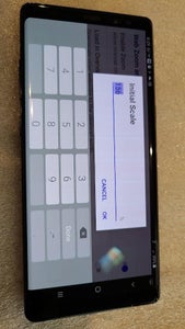

Finally, select 'Initial Scale'. This setting allows the clocks to be resized properly to the display being used. You can see from the example picture that I set it to 156%. Your setting will probably be different.
Once done, create a shortcut to the phone's desktop for easy launching. When you quit and relaunch the shortcut the clockclock should come up in the same location in which it was setup.

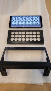

Step 4: Create Desktop Frame Display
The final part is to create a display frame of sorts. I chose to 3D print such a frame. I decided to do this in 2 pieces. The frame and a face plate.
I chose to create the face plate separately so I could easily reprint the face plate if I had messed up on my measurements of the clock faces on the phone. As it turned out I only had to reprint once. But this was still much quicker than reprinting the whole frame.
Obviously, the attached STL files are specifically dimensioned to fit the Samsung Note 8. If you would like to create your own display frame by 3D printing, I'd highly recommend using the site, Onshape.com. There is a small learning curve but there are plenty of tutorials to help a person get started. Onshape offers their awesome web based software free of charge and is a very impressive web app.
If you don't own a 3D printer, there are many online services that can be used where you upload your STL files and they print and send the finished product back to you. I've used 'The Hubs' with great success in the past.
