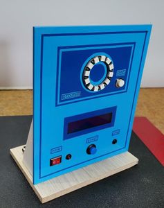

This game is based on the Cyclone arcade game, where the player tries to stop an led scrolling around a circle at a specific spot.
In one of my previous videos(https://youtu.be/1K0vr-hrh0k), I presented you the same game, but on a large ring consisting of 60 Leds, which contained several levels.
This time I use a small ring with 12 Leds and the game does not contain levels but is a continuous game until once the target marker is not hit.
In addition, there is an LCD display that shows highscore and current round.
The code was taken from Joern Weise's GitHub page (https://github.com/M3taKn1ght/Blog-Repo/tree/master/Cyclone), and I made some modifications.
First I shortened the way of testing the LEDs, and then added different sounds for each segment of the game so that it is now much more interesting.

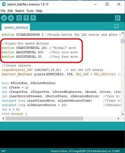

As for the gameplay, as I mentioned before, in this case there are no levels with increasing speed, but each successive round starts with a randomized speed, and generally the speeds can be easily changed in the code in the lines:
#define STARTINTERVAL 250 //"Normal" move
#define MAXINTERVAL 500 //Very slow move
#define MININTERVAL 50 //Very fast move
Now let's see how the device works in reality.
When turning on the game, all LEDs light up sequentially accompanied by an appropriate sound effect, and a corresponding message about the test on the LCD display.
Next, by pressing the button the game starts. The goal is to press the button at the moment when the rotating diode is located exactly on the static diodes. In the first two levels, three diodes are static, and in the next levels only one. The number of laps completed and the score are shown on the display. If we fail to hit the red Led, the game ends, and High Score appears on the display. The number of laps completed and the score are shown on the display. Otherwise, the high score is recorded in the eprom of the microcontroller so that it is saved even after the reset. If we want to delete the high score, when turning on, we hold down the HSR button.
And finally, the game is mounted on a PVC board with a thickness of 3 mm and covered with self-adhesive colored wallpaper.
