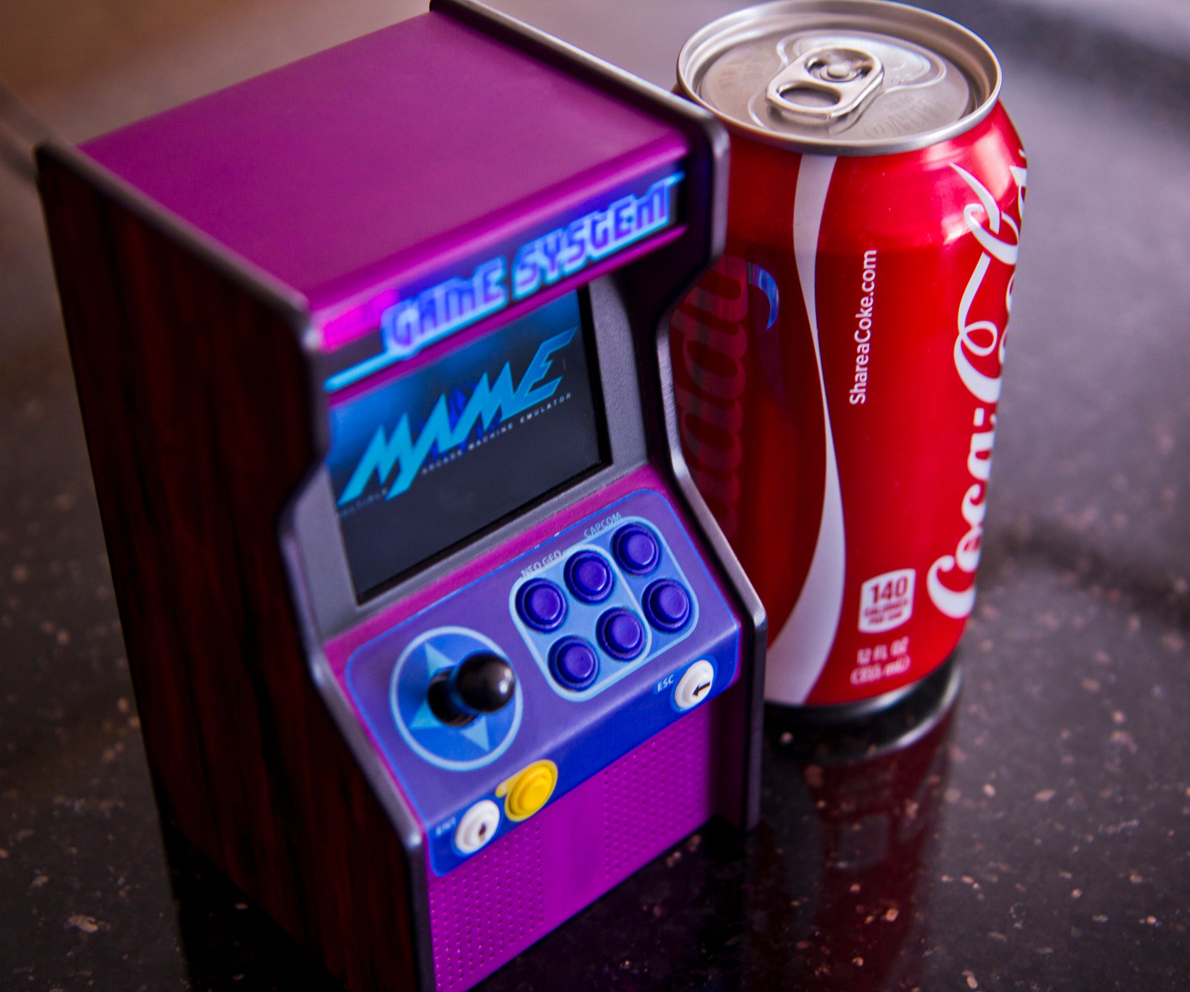

For more details on painting and decal application see my micro arcade cabinet tutorial.
