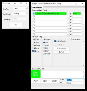

Download this Bin File. Download the Espressif Flash Download Tool from https://www.espressif.com/en/support/download/other-tools. Unzip it. Plug the D1 Mini ESP32 into the computer's USB port and run the flash_download_tool_3.9.5.exe.
Set ChipType to ESP32 and OK it.

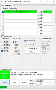

Change the setting in the Flash Tool so that it reflects the settings in the above image. (you have to type in the 0x00)
Select your active COM port and click start. Once the upload has finished, unplug the ESP32... job done..
