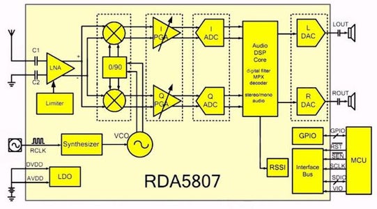

See the attached manufacturers datasheet and the internal diagram for details of this little wonder.

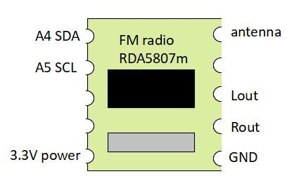

Step 2: Preparing the Radio Circuit RDA5807m

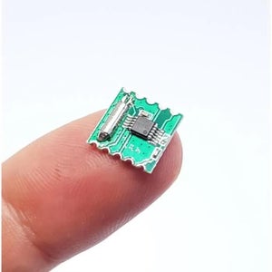

The radio circuit I used (the RDA5807m) is an SMD or surface-mounted device, an electronic component that you find on the surface of a board. The distance between the connections (a row of five on each side) is not the same as used for standard through-hole PCB's. which is 0.1inch. This is why I made a small PCB of 7x7 holes with round copper connections on top and two rows of five male header pins pointing down to provide the radio chip with proper connections.
It is very tricky to solder the chip on this board, I tried to use small wire connections but this failed because during soldering one end of a wire the other end came loose every time. So I made the connections with only solder. I damaged my first chip because one of the copper circular connections caused a short circuit during testing between two chip connections. (GND and one of the output connections).

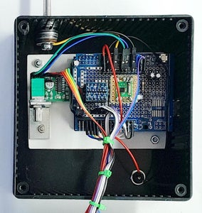

Step 3: The Arduino UNO R3 Adapter Board

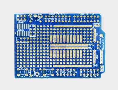

I first made a setup for the complete radio on a breadboard using a lot of colored wires with dupunt connectors. After a lot of tinkering it worked as expected. In the next step I added the radio chip together with the level converter, the resistor for the stereo led, the four capacitors, the reset button and the rows of header pins on a compact adapter board for the Arduino UNO R3. The result is a very compact combination of parts.
The level converter is neccessary because the radio chip uses a voltage level of 3.3V for the SDA and SDL control connections. The Arduino however sends and receives these signals on a 5V level. When you do not use the converter, you might kill the radio chip...
Both little circuits (the radio chip with its new connectors and the level converter) are mounted on the adapter board with female header pins. So both chips can be replaced when someting goes wrong. I used an adapter board designed for an Arduino Leonardo ( because is was sold for a very low price). If you use an original UNO R3 adapter board you must check the wiring connections, they might be different from my design.
The wiring on the adapter board is partly bare and insulated where needed to avoid short-circuiting the connections.

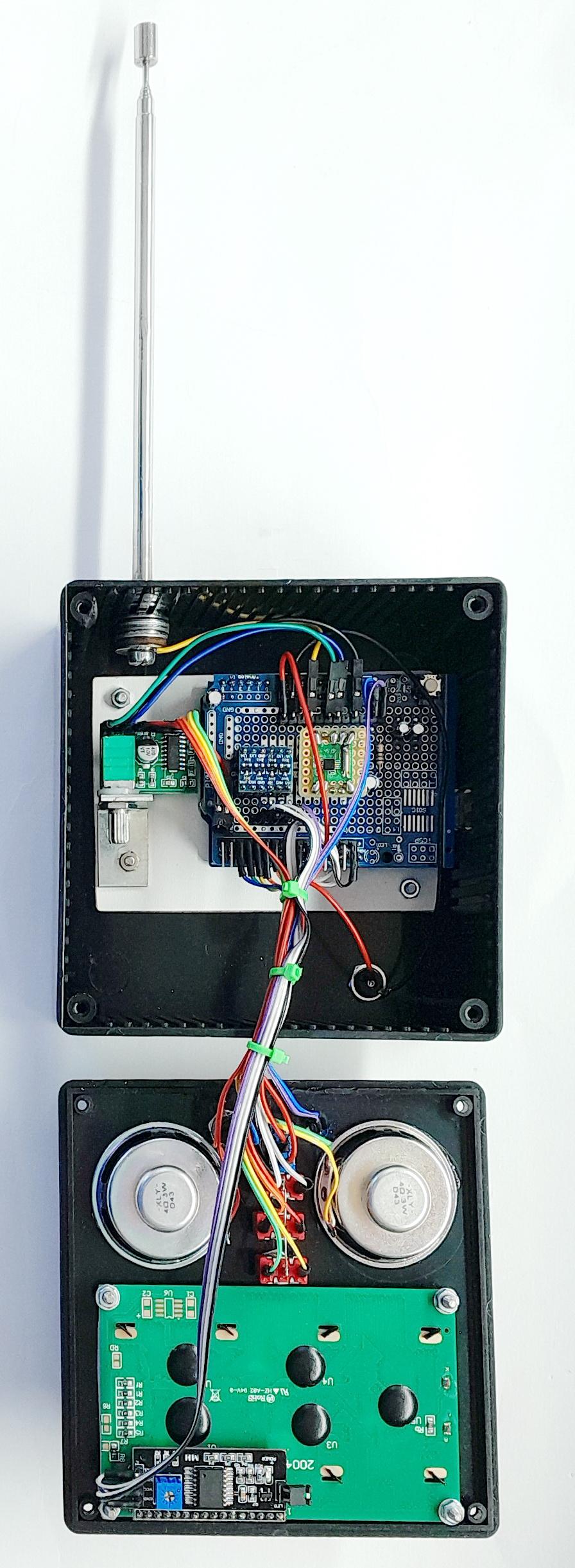

Step 4: Combining the Arduino, the Adapter Board and the Audio Amplifier

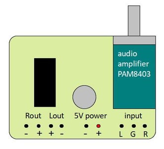

The RDA5807m chip has no power audio amplifier on board, so I added a small 2x3 Watt integrated amplifier type PAM8403. The Arduino UNO R3 with its adapter board and the amplifier are mounted side by side on a small wooden base plate for easy wiring when the parts are not yet mounted inside the box. For the amplifier I used an L-shaped metal bracket. The audio volume level is set with a tumbler switch via the software, the volume control knob on the audio amplifier is used as a preset to avoid audio distortion when the level is set to maximum.
Mount the Arduino on the right side of the base plate with the USB-B connection protruding, this connection must be accessible through the right side of the box.
Step 5: Assembling the Box Front Cover With the Controls
I decided that it would be easy to mount all controls, the speakers and the LCD screen on the front cover of the box. In this design you get a minimum of wire bundles (in fact just one) and soldering the wiring becomes very easy. The holes for the tumbler switches are 6mm, the hole for the pushbutton is 7mm. and for the led it is 5mm. Both speakers are 40mm, I used a hole of 35mm for each speaker so they could be glued to the surface. The LCD screen is flush mounted with 4 spacers of 5mm. on the upper part of the cover using a rectangular hole. The tumbler switches for station search, volume control and memory storage switch in horizontal direction, the tumbler switch for the power supply switches up and down.
Step 6: The Wiring, Antenna and Power Plug

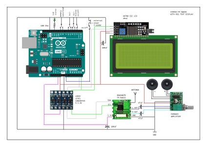

See the wiring diagram and the audio amplifier pinout for the correct connections.
Take care, connecting the power supply or the speakers incorrectly could damage the amplifier or even the Arduino. For the wiring I used multi-stranded colored wiring and I insulated the soldered connections with shrink sleeve.
For the connections between the adapter board and the audio amplifier I used dupont connectors on one side to make disconnection easier.
Make a hole in the back side of the box for the power supply plug. and a hole for the antenna on the top side.
Carefully make a square hole for the USB-B connector of the Arduino R3 on the right side of the box, this connection will be used for software updates and power supply (with an USB charger).
I mounted the antenna with a M5 bolt inside the box and for this I soldered an M5 nut on the bottom side of the antenna.
