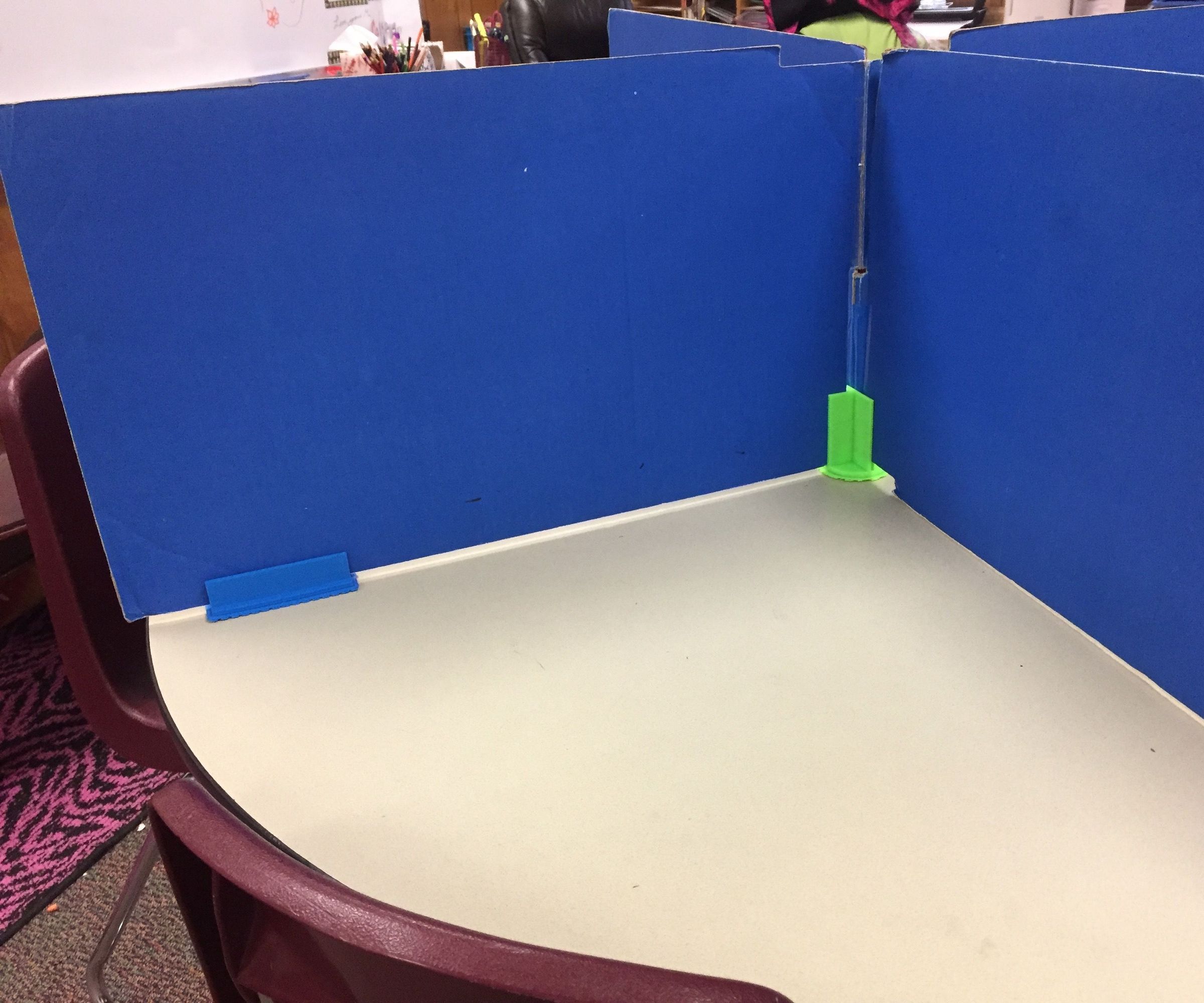

Step 2: Create the Holder in Tinkercad
The holder was created in Tinkercad using the cylinder tool. The bottom cylinder is 30 mm in diameter and 4 mm in depth. The top cylinder is 7 mm in diameter with a 5 mm hole through the center. It is 50 mm tall. It is placed on the base at a 30 degree angle.
Step 3: Print the Holders
The holders were printed on a MakerBot 5th generation Replicator, 3 at a time. Attach a magnet to the underside of the base so that it will stick to the metal door frame.
