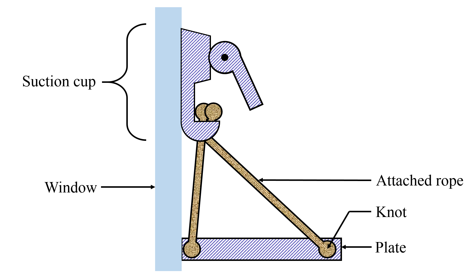

First method: I have used 4 pieces of rope. Each piece connects a corner of the plate to a suction cup. This technique has the advantage of being very stable, the rope cannot move. But on the other side, it is more difficult to make all the 4 knots at a good distance so the plate is perfectly horizontal. Below is a scheme of the shelf seen from the side.

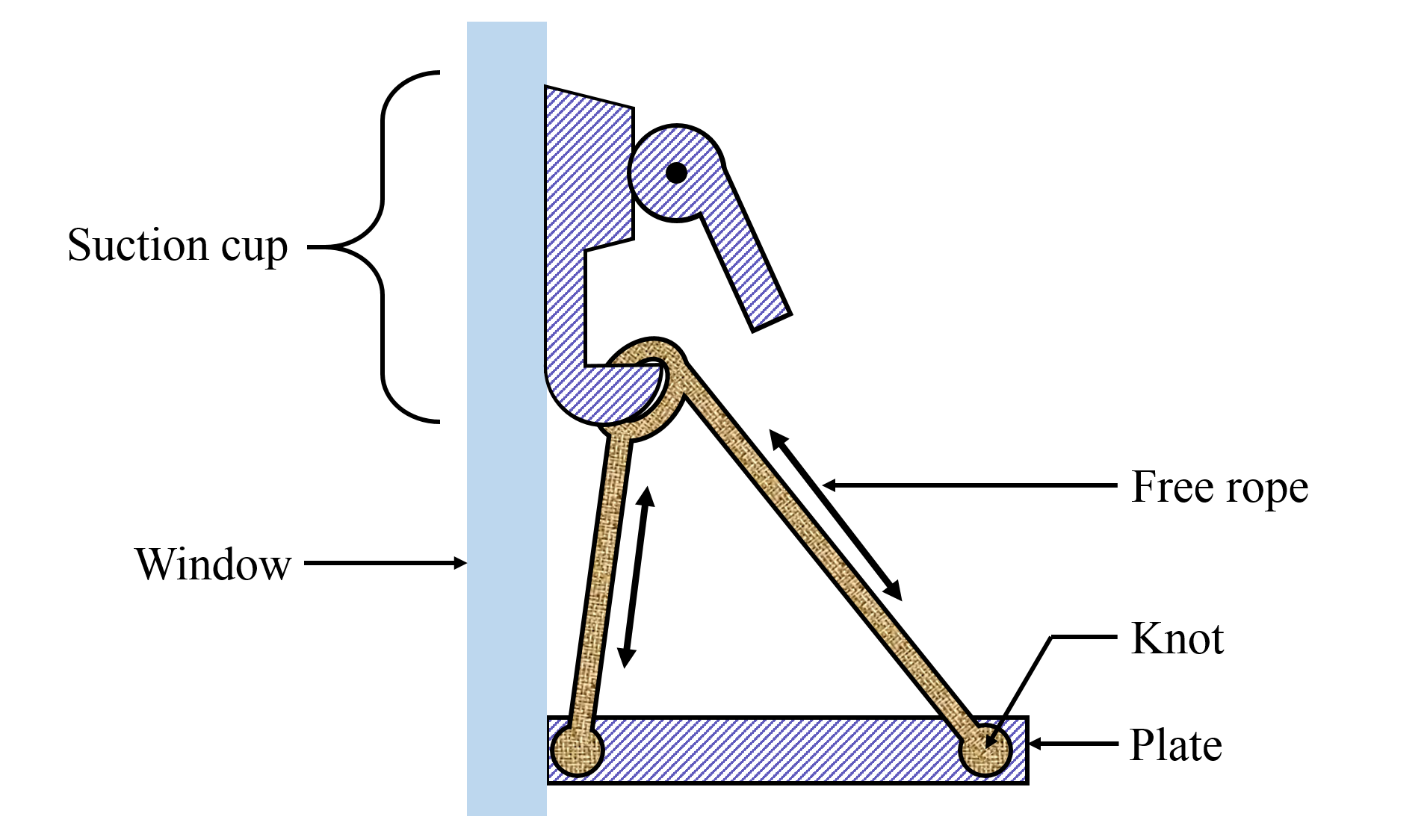

Second method: I have also used only 2 pieces of rope and I have made a loop on the suction cups. Each piece is connected to a single suction cup. With this technique, it is possible to adjust the length of the rope on each side. But the rope can slip and the object placed on the plate can fall. So this has to be done with a rough rope. I have used this technique lately, and it works perfectly.
