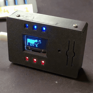

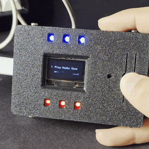

  1. This is a simple gaming console running on ESP32 with a built-in 0.96-inch OLED Display.
  2. The game, navigation, and play are all done by a single button.
  3. The built-in display on the ESP32 module acts as the screen.
  4. LEDs light up in various animations to show start/win/lose, etc.
  5. The buzzer sounds with varying frequency to generate different tones.
  6. Easy customization and firmware upgrade.

The hardware side is pretty simple. Here, I have used a breadboard to hold all the components. The circuit is built with around the ESP32 LoRa Module, which acts as the main controller. ESP32 sits perfectly on the breadboard, leaving all the pins on either side of the board.
The system is powered by 5V coming from the USB. The development board contains a 3.3V regulator, which I used for lights and button input.
The development board cannot output enough current, so I used generic PNP transistors (BC557) to switch the LEDs and the Buzzer. The LEDs are connected in parallel so they blink at the same time.
The input push button is connected to a 1k pull-up resistor (it reads HIGH when not pressed), which is a good practice to avoid ghost trigger.
The additional 100nF capacitor connected to with switch is very important to counter the debounce effect as we will use an interrupt to read the button inputs.
Step 3: Enclosure
The enclosure is 3d printed using black filament. The cutouts exactly match the component on the breadboard. There is still space for a small battery, which I will add in the updated version :).

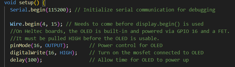

Step 4: Coding
GitHub link: https://github.com/AlAminAshik/Mini-game-consol-using-lora-display-esp32.git
I tried to keep the code simple to allow everyone to understand. The code could be made neater by creating some custom libraries, but for now, I kept everything under main.cpp
# Important: To use the built-in OLED display of the development board, there are some adjustments to be made to the code. On the Heltec board, the OLED display can be powered on/off, so to turn it on, pull the GPIO 16 pin to HIGH at the initial setup. I have attached a screenshot of the code.
The code is divided into different sections, and I have discussed the different blocks of code below:
