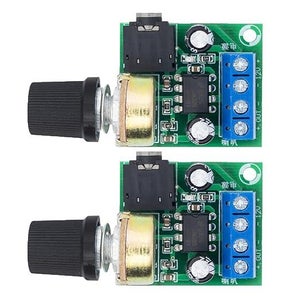

Lm386 Acxio 10W mini amplifier board. -----> https://a.co/d/h4dCohX

The second step I took was to connect the 9 volt connector to the Acxio board with a screwdriver. (Before and after)
Note- *Make sure the - and + battery wires are in the correct spot as marked on the Acxio Board.*

Connect the aux 3.5mm jack to the Acxio board
