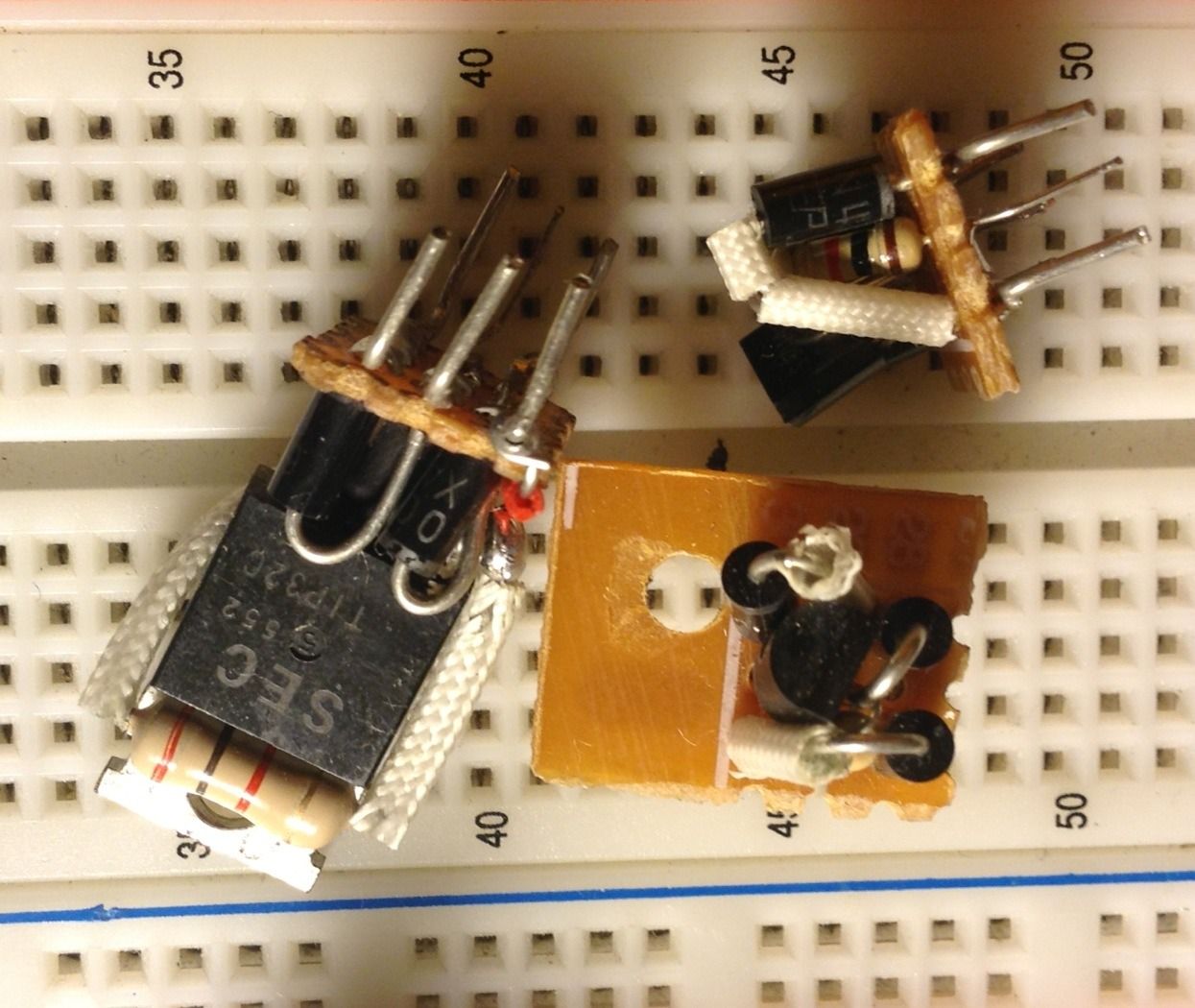

So we'll start with the fujifilm camera, first we need to get the camera,(fuji obviously) once you pry it open, desolder the transformer, transistor and the 220Ω resistor and maybe everything else. Then just follow the images, they explain all.

Starting from this page, is minimizing the Kodak PowerFlash (Pardon the irritatingly lit lighting). Above is what the circuit should look like (orange PCB, 4 pin transformer...). You can start by drawing a guide line like I have to divide what we want (the general transformer area), and what we generally don't need. Then desolder the smaller capacitor and either the SMD diode (Located where the most SMD's are found) if you know how to remove them without breaking them or just the normal diode.
Next, cut the cubic transformer area out being sure to have already removed all other disturbances in the way. Scratch a bit of enamel off the copper on the output end connecting to the xenon tube (picture 3 labelled D1) if you are using the SMD diode.
Once you've soldered the diode on, get the small capacitor and solder its contacts to vcc and that copper that is between the two transistors.
Once done that, you just need to solder the input/output contacts and you're done.
