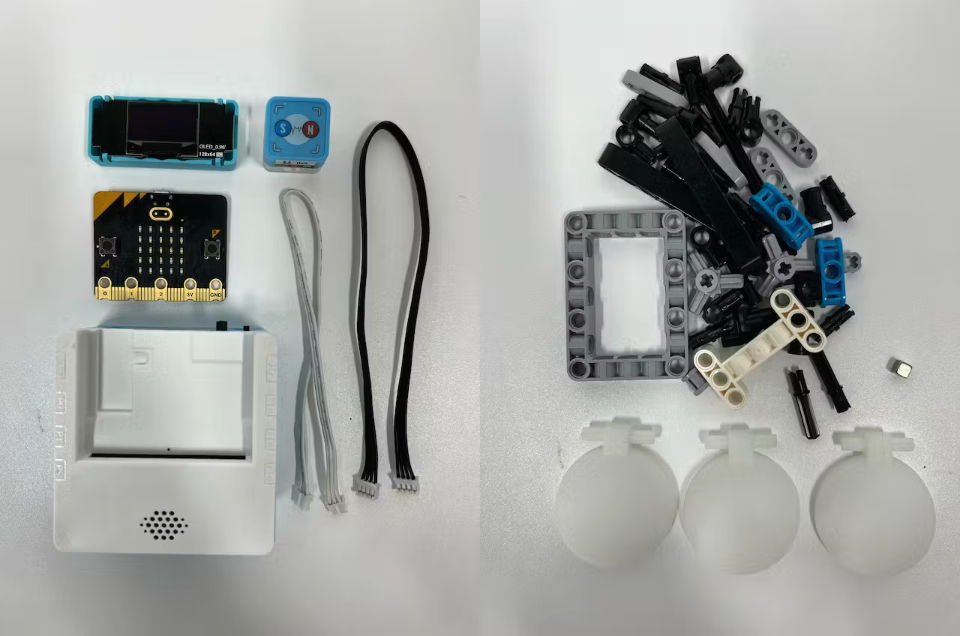

Hardware
Micro:bit V2 * 1
SugarBox Expansion Board *1
Sugar Hall Sensor *1
OLED Module *1
3D Printed Part
several LEGO bricks
small magnet

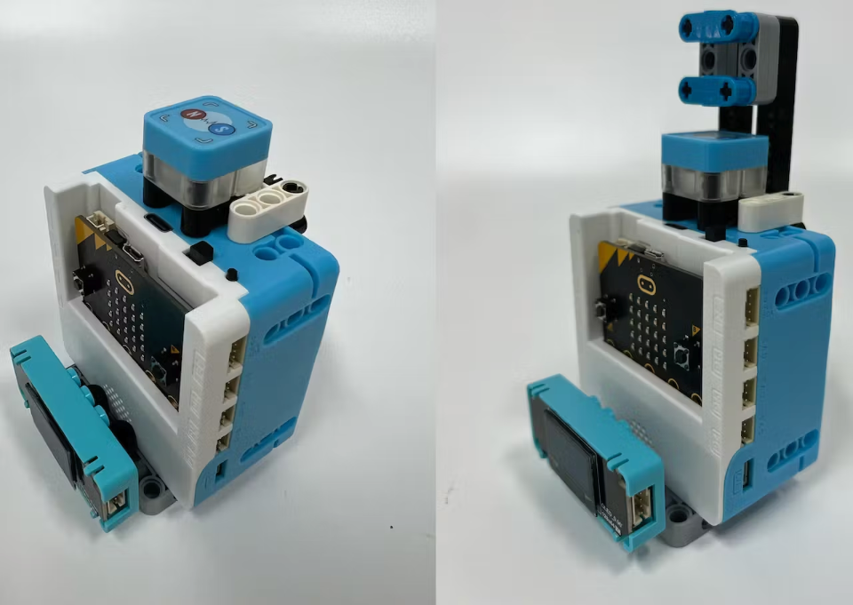

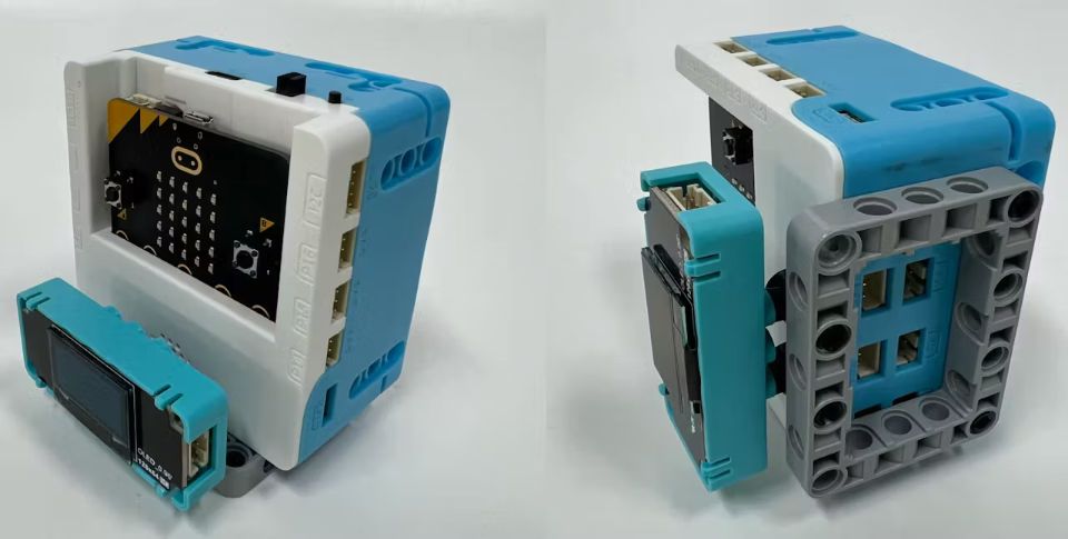

Insert the Micro:bit V2 into the slot of the SugarBox Expansion Board and secure the OLED Module directly in front of it for easy observation of the changes in wind speed values.

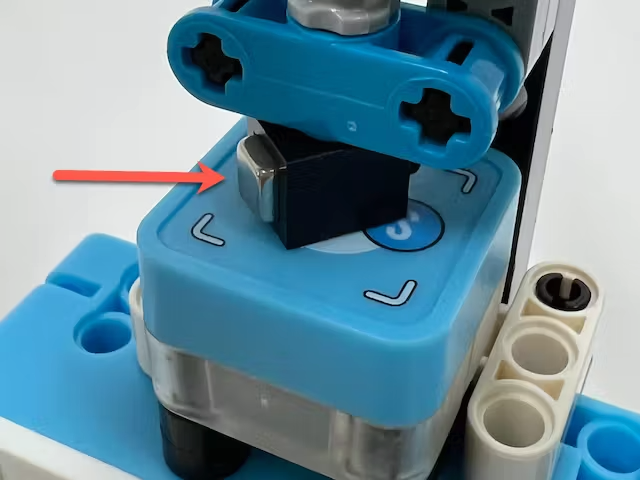

Secure the Sugar Hall Sensor on top to detect the presence of a magnet. Then install the mounting structure for the simple wind-receiving structure.

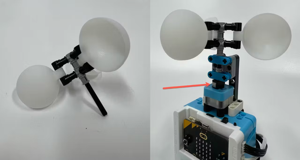

Install the simple wind-receiving structure and place the small magnet into the square hole of the LEGO brick.

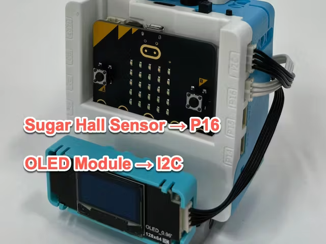

Connect the modules and expansion boards together.

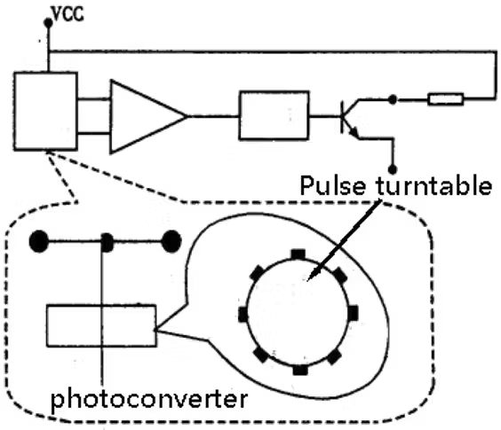

To calculate wind speed let's start with the principle of an anemometer. Below is the schematic diagram of the photoelectric anemometer, the three wind cup to turn the rotary table. There are several teeth on the turntable, and the LED beam is cut by the teeth on the gear plate, which will generate a pulse signal. As the wheel rotates, the teeth of the wheel cut the light beam, which sends out pulses representing wind speed.

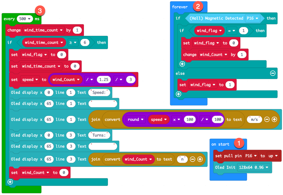

Now make an anemometer program that counts the number of turns every three seconds and calculates the wind speed by the number of turns. Display winding number and wind speed and add units on OLED at the same time.
①The program's pins and screens are initialized first.
②Set wind_flag variable state, set the variable to 0 and increase the number of turns by 1 when magnet is detected, set wind_flag variable to 1 when no magnet is detected. The winding number can be calculated accurately by this method.
③The number of turns and wind speed are displayed every 3 seconds.
