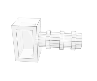

Add the small square of cloth to the pump inlet to act as a filter (Secure with a zip-tie)
Attach the tube to the pump outlet (cut to length so the tube sits at the top of the can)
Insert the tube up the big hole in the small can. (Fit a [optional] 3D diffuser to disperse the water)
[I've attached the STL file for my simple diffuser]

(Optionally you can add a small diffuser to the top of the pipe to spread the water when the pump is on)
