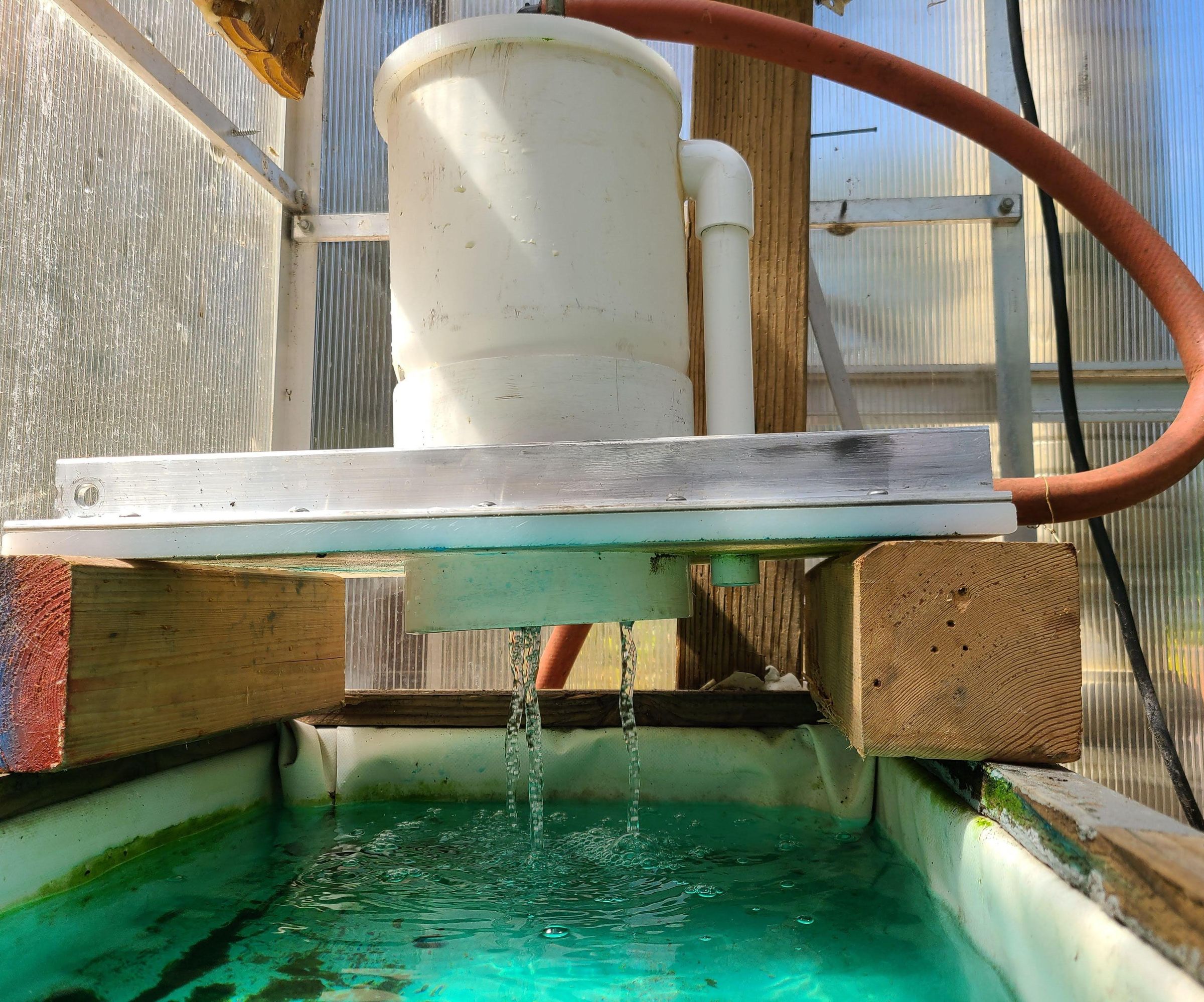

I built a self watering greenhouse a few months ago. the self watering system has worked OK for the most part... But.. it does develop some nasty green slime in the water, due to lack of oxygen and circulation. My plan is sometime this winter I'm going to convert the still water basins to ebb and flow hydroponic. I only have about 2 amps 12 volts of solar available. So running an aerator with a stone and a pump is out of the equation. Why not kill 2 birds by having the pump do both? I settled on a 12 volt 325 GPH pump that draws around 2.5 amps. I want to keep the head pressure and restrictions to a minimum. So I designed the 4 venturi mini tower aeration system. Based on Bernoulli’s Principal, which states that as the speed of a fluid increases, the pressure within it decreases.
1-30-14, I have an actual system up and running using the mini tower, I made a few changes to the project based on my observations to maximize aeration. My circulating pump, in the system, is about 150 gph at a 7' head.

Put it all together, I turned a piece of 1/4 inch acrylic to a 4 inch diameter and bored 4 holes in it for the four venturis then crazy glued the venturis to the piece. this will sit inside a piece 4" plastic drain pipe and create the tower. The water is pumped into the top of the tower and flows threw the venturis via gravity this is based on Bernoulli’s Principal, which states that as the speed of a fluid increases, the pressure within it decreases. A couple of pieces of cedar hold up the quad venturi, inside the drain pipe. the screw in the middle just fills the hole used for turning the piece. Seal the acrylic plate to the drain pipe with silicone.
Step 6: Houston We Have Aeration
This is what I like to see. tiny bubbles!
Step 7: Hydroponic Green House Is Going a Little Crazy Now
Hydro Mini Towers at work. I have 3 of them in my greenhouse hydroponic system. the worked great for the lettuce, arugula and watercress over the winter. I'm starting tomatoes, basil and cantaloupe for the spring / summer season now.Last picture is the first cantaloupe.
