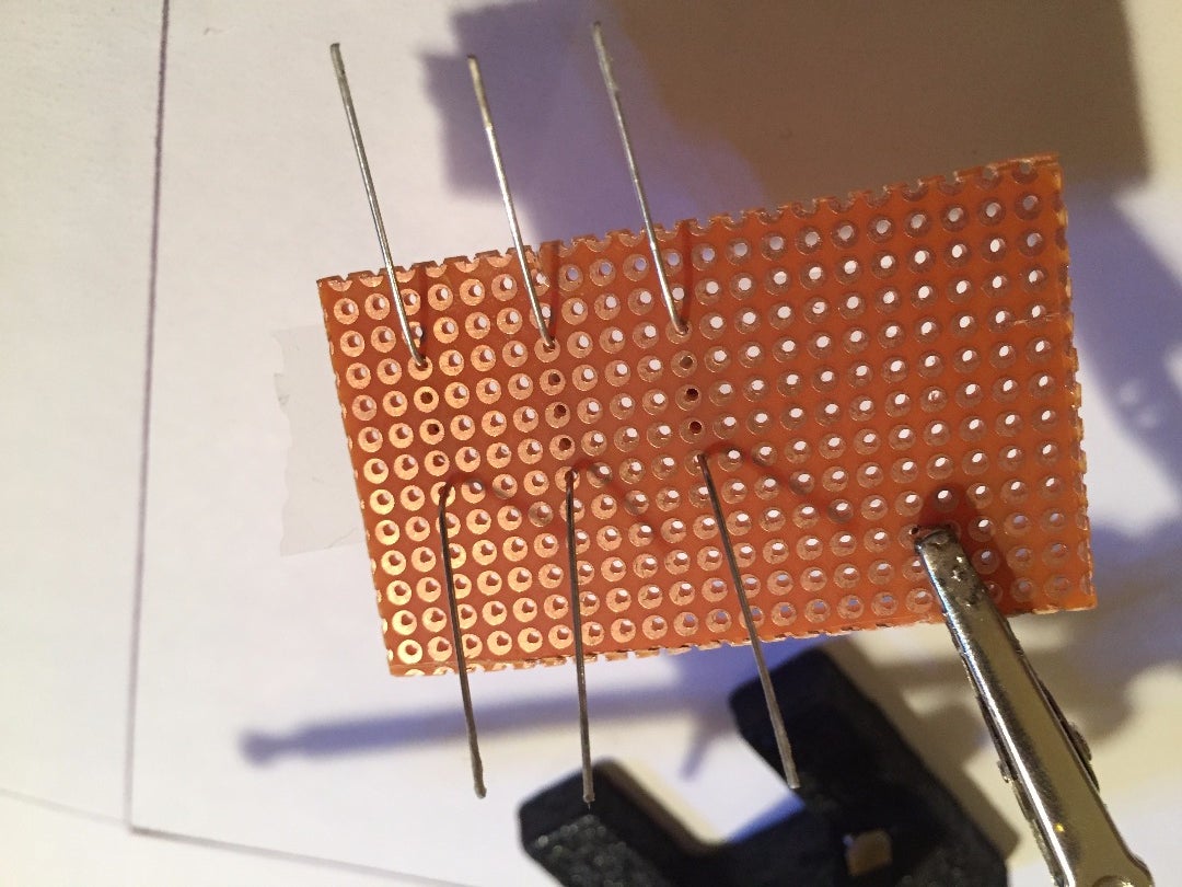

The first thing you need to do is to bend the legs of the 3 resitors.
The resistors:
1- Place the resistors like show on the photos.
2- Place some tape to keep them in place.
3- Flip the board over and solder the legs in place.
4- Cut the legs with the wire cutter. Wear safety glasses!!!
