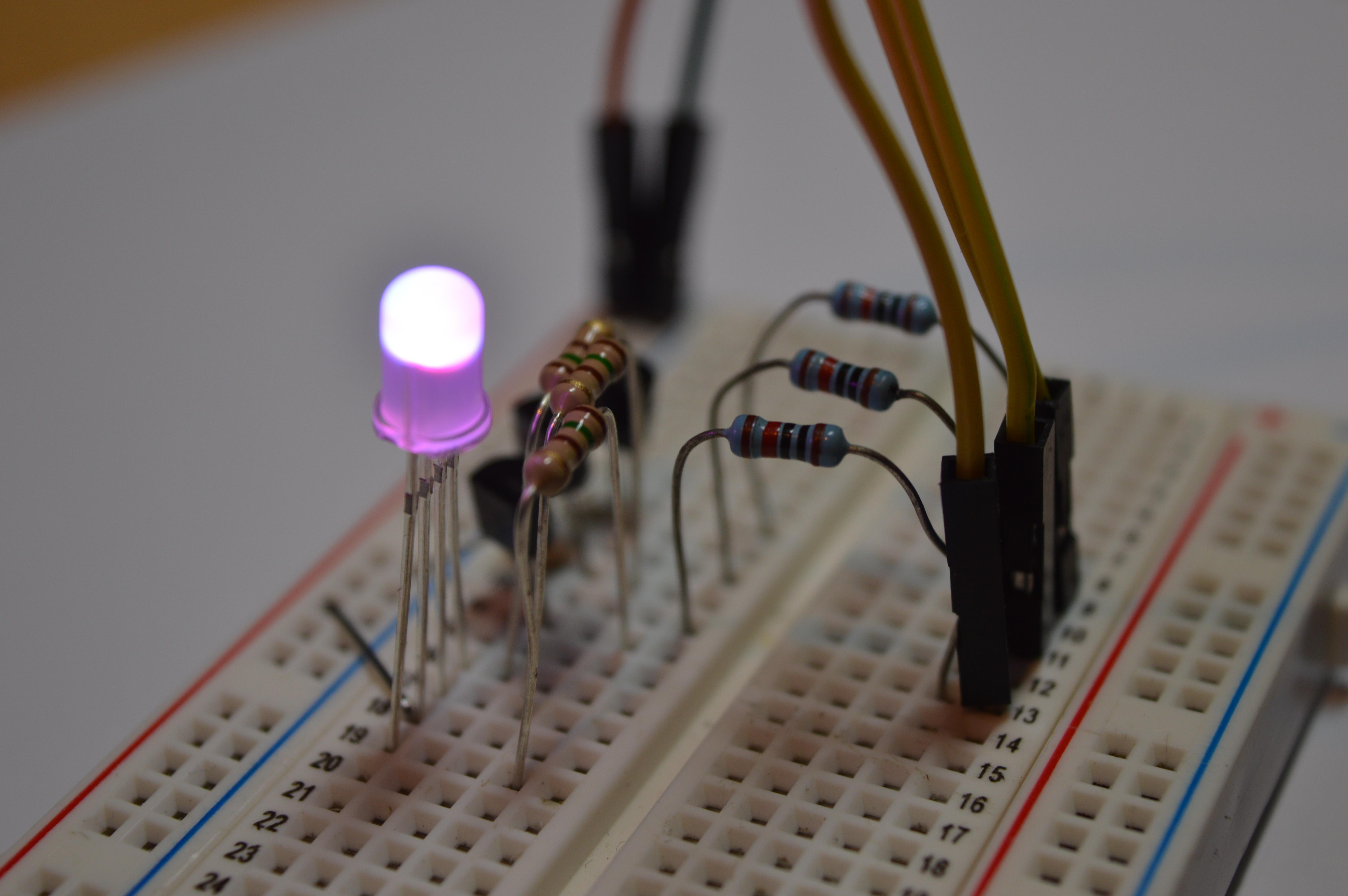

Once this PCB had been soldered I checked that it functioned by hooking it up to an Arduino Nano running the "Colour Pallet" Example Sketch from the FastLED Library. To test the white LEDs I ran 5v through them.
