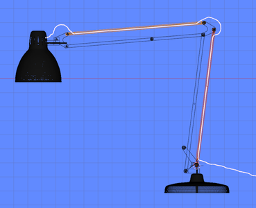

Step 1: DESIGN BASIS
The LUXO mini lamp must be fully functional.
It must be possible to select between two types of base: clamp and firm base.
The clamp-type base must be fully functional, allowing the lamp to be held in various positions.
The lamp must be able to rotate on its base.
The lamp must be able to articulate its arms.
The lamp must allow the lamp head to be rotated in the pan & tilt angles.
The internal head of the lamp must have a reflective surface.
The lamp must have a 3W white LED.
The electrical system cables must pass through the inside of the struts.
The lamp must be powered through a USB port

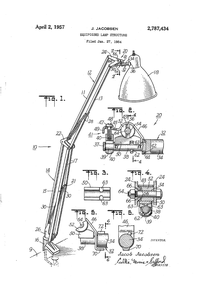

Step 2: PATENT No. 2,787,434
The patent 2,787,434 is a patent granted in the United States and is related to improvements in balanced-spring lamps, specifically in the articulation mechanism of the lamp arms. It was granted on April 2, 1957, to the Norwegian inventor Jac Jacobsen, the creator of the popular Luxo lamps.
The patent describes an articulation system for lamp arms that includes a combination of pivots and springs that allow smooth and balanced movement in various directions. This design allows the lamp to be easily adjusted to different positions and angles, providing optimal lighting in any situation.
The mechanism patented in patent 2,787,434 significantly improved the design of balanced-spring lamps, contributing to the success and popularity of Luxo lamps. This type of lamp has become a standard in work environments where adjustable and high-quality lighting is required.

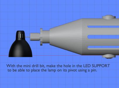

Step 21: ELECTRIC SYSTEM: Placing the Led Inside the Lamp Head
Carefully pass the cables through the inside of the lamp head and take them out through the rear hole. Then pull the wires until you can place the Led Support inside the lamp head and tighten firmly.
NOTE: With the mini drill bit, make the hole in the Led Support to be able to place the lamp on its pivot using a pin.

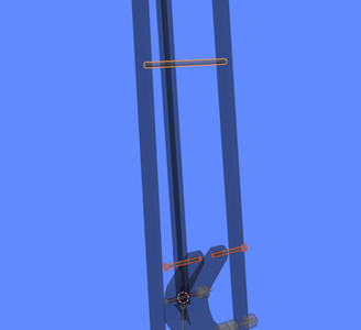

Step 25: ASSEMBLY: Clamp
TOOLS:
Wire Stripper Tool
MATERIAL:
M3 screw (from step 13)
Pin
3D PRINTED PARTS:
Clamp.stl (from step 15 & 16)
Base Screw Clamp.stl
STEP:
  • Place the Base Screw Clamp on the end where the screw was cut and screw it in tightly.
  • Using a small drill bit, grind the hole for the pin.
  • Pass the pin over the hole and fold the tip and cut off the excess with the Wire Stripper Tool. Look at the figure to see how to do it.
  • Insert the Bushing (from step 9) into the corresponding hole. If necessary, apply a little quick-drying glue.
  • Put the screw in place and you're done.
Step 26: ASSEMBLY: Lamp Head
TOOLS:
Wire Stripper Tool
MATERIAL:
Pin
3D PRINTED PARTS:
lamp_head.stl (from Step 21)
pivot_joint.stl
STEP:
  • Cut the pin to the required length to be able to insert it into the lamp (20 - 22 mm).
  • Pass the pin through the hole in the pivot_joint and insert it into the hole you made in the Led Support (step 21).

Step 32: ASSEMBLY: Wiring
Carefully insert the lamp wire inside the carbon fiber tubes. The entry and exit of the wire are through the slots we made in the carbon fiber tubes in step 14. This is the most difficult step of all and requires a lot of patience.
NOTE: You can use the tip of a pin to guide the cable exit.
Step 33: FINAL WIRING
Finally, we are going to solder the USB cable that we prepared in step 22 with the cables that we just passed through the interior of the carbon fiber tubes...and...
THAT'S IT...
