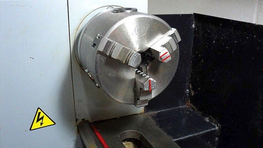

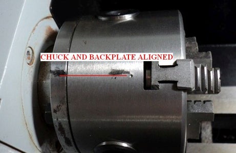

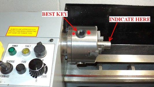

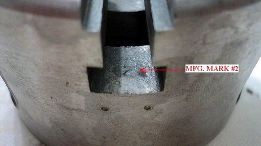

Scrolling chucks use a set of numbered jaws which must go back in a particular slot. I identify my jaws with a I or a II slot cut on the face edge, and a corresponding punch mark on the chuck body. I leave #3 assembly blank as it's codification is not necessary since it will be the only unmarked jaw and chuck position. Further, the chuck body should also be aligned with the backplate of both types, screw or bolt. I simply used a punch mark opposite the #1 jaw for this purpose. If you have never done this, then the reassembly- remount step would be a good time to rotate it through the 3 or 4 mounting positions, recording the run-out figures with a dial indicator and then marking the best choice for future reference and cleaning. Don't expect “0.000”, as most 3- jaw chucks aren't made that accurate, but mine indicated in at .003” [.0762mm], measure for this 1st step. The next step is to find the optimum key position to use when mounting work.
When chucks are assembled at the factory only one key position is constantly used during the jaw grinding operation, usually it is either the #1 jaw or the keyhole inline with the logo if the chuck has one. The other keys will be of lesser accuracy if tightened. The way to determine this and the previous step is to use a dial indicator and a short stub- I use a center-less ground dowel pin- to locate and mark this key. On my chuck, following the above steps, I have runout reduced to .0015”, and marked it with red paint spots.

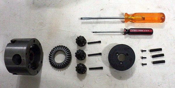

As the chuck is disassembled, put the parts in order of removal, and take an image shot before doing the actual cleaning. This will be helpful for reassembly after cleaning and inspection.

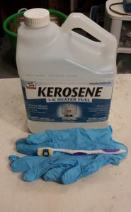

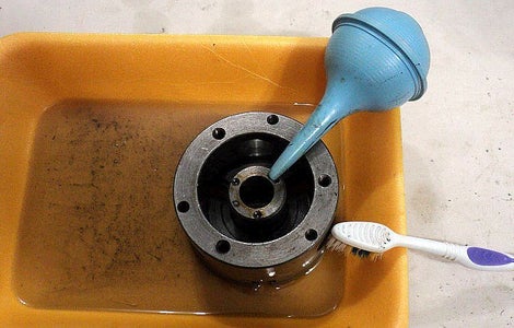

I use Kerosene for cleaning; it is inexpensive, mild, flushes out all particulates, and can easily be clarified to reclaim nearly all of it for reuse; mineral spirits would work just as good too. An old toothbrush is put to it's final use here as well as rags and toilet paper.

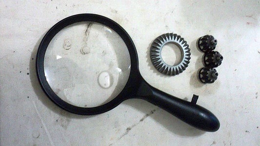

A cheap aspirator syringe works great for flushing out the crud from tight places, and a simple hand lens is employed to visually inspect for cleanliness and impacted debris.
The last image is of the schmutz washed out from my chuck assembly. I let it settle, and when clarified pour it off into a bottle and use it as a cutting lube for aluminum or other shop cleaning chores.

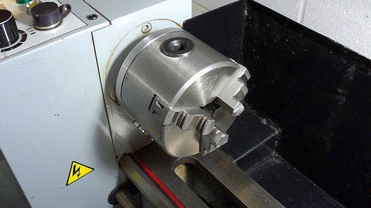

Put it back together in the reverse order of disassembly and remount on the machine.
Working with jaw #1 at the bottom 6:00 position, rotate the scroll plate around until you see the tapered end of the scroll just move past and away from the slot. Insert #1 jaw, and turn the scroll plate to lock in the jaw. Continue on to jaw #2 and then 3, doing the same procedure. Don't rotate the chuck, just work in this position, it's the easiest way to get it all back together. Wrench the plate until all 3 jaws meet in the center, and your chuck maintenance is done.
