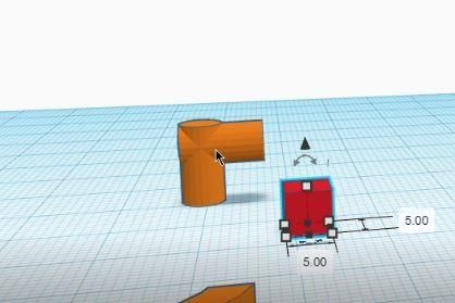

Step 5: Let's Make His Neck
Now that we have the bulk of the body out of the way, let's make the neck. If you look closely, WALL-E's neck boils down to a couple cylinders connected by a cube. Easy enough!
Make two small and thing cylinders, rotate one of them until they are perpendicular, and align them at their top corners to make an L-shape. Make a cube the same size as your cylinder's diameters, and align that over where the two cylinders connect.
Move the group to the top of your WALL-E and resize each piece as needed. I needed to make the cylinders longer, but my cube stayed the same. I also rotated the top cylinder to match the usual angle we see on our reference images.
When the angles, size, and position look right, join the 3 neck objects (cylinder, cylinder, cube) and make them WALL-E colored. I used the orange instead of the gold for this, to help me distinguish during the next few steps.

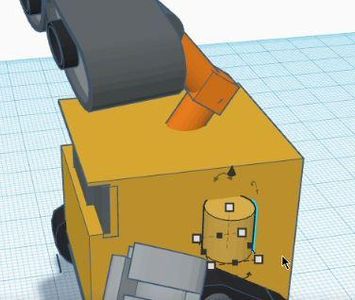

Step 11: Up in Arms
To attach the claws, I made a simplistic "arm" out of a cylinder. I made the cylinder WALL-E colored, and positioned the claw at the end.
To attach the arm to the body cube, I added a cylinder to be the "joint" where we can easily attach the arm! Made it WALL-E colored, then duplicated and aligned on the other side.
I aligned the cylinders for the shoulders before adding the arms so that we could position our WALL-E's arms any way that we want!
Once those are in place, put on your arms. Have fun, find the most WALL-E-EST position you can possibly find!

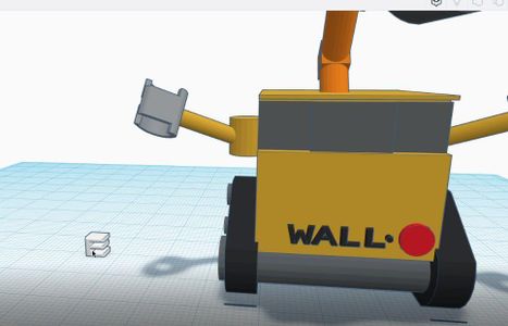

Step 12: Just a Few More Things
Now, we just have to add the finishing touches.
First off, the WALL-E text. I used the "text" shape, and just put "WALL" (no quotes) in black using Sans Mono font.
I used a small black cylinder for the dot between WALL and E, and a larger red cylinder as a background for the E.
The E was the same process as the WALL text. Type, Settings, Rotate, & Align.
I used a black cube resized into a flattish rectangle to make a little panel for his battery level display.
For the red button, I used a "Dice" shape, resized into a small rectangular red button positioned beside the display.
I noticed around this time that I still had a few floating bits, and went back to clean them up as well.
