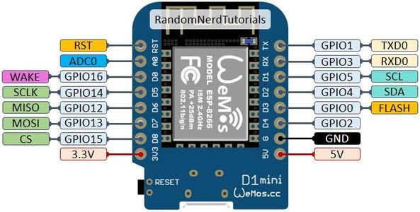

Step 1: Wiring
How to connect the Board to the screen:
GND to GND
3.3V to VCC
D1 to SCL
D2() to SDA
It is best to solder these connections, and make sure there's not too much bare wire exposed, since we will stuff it in a box in a later step and we want to make sure there are no shorts.

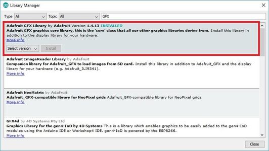

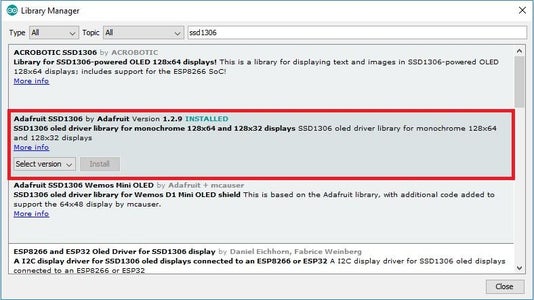

Install two Adafruit libraries to control the display:
Adafruit SSD1306:https://github.com/adafruit/Adafruit_SSD1306
Adafruit GFX:https://github.com/adafruit/Adafruit_SSD1306
While you could download and install via Github links above, it's easier to download via the built in Library Manager.
  1. Open your Arduino IDE and go to Sketch Include Library > Manage Libraries. The Library Manager should open.
  2. Type “SSD1306” in the search box and install the SSD1306 library from Adafruit.
  3. After installing the SSD1306 library from Adafruit, you may get a notification that there are other libraries needed. Select the option to download all. If you didn't do this, you can always type “GFX” in the Manage Libraries search box and install the library manually.
  4. You will need to make sure you installed the ESP32 add-on into your Arduino IDE. If not, follow these instructions. (My board is the Wemos Clone)
  5. If you aren't seeing your board show up in the COM port options at the top of Arduino IDE, please install the CH340 driver.
  6. After installing everything, restart your Arduino IDE.
