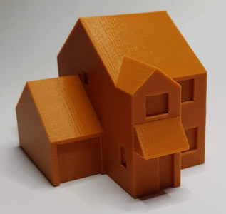

The finished print with support material is shown in the first five pictures.
Carefully remove the model from the print bed. I recommend using bespoke tools for this as they are less likely to damage the bed surface - I use a pair of tools from Reptor - Picture 6.
Remove the support material from the model - this breaks away easily.
The final model is shown in pictures 7, 8 and 9.
