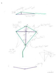

I choose a diamond kite design. I was not sure if taking the proportions down to a mini scale would work.
I like to draw up a simple design with dimensions
The weight of my material was my biggest concern. (being to heavy to fly).
I choose foils for the sail & tail - and light weight plastics for spars.
Part of this design requires the horizontal spar to bend uniformly and maintain a bow.
I choose plastic sweeping broom bristles - which I knew would flex and hold up.
I cut pieces from my wife's garage broom, which so far she has not noticed them missing.
