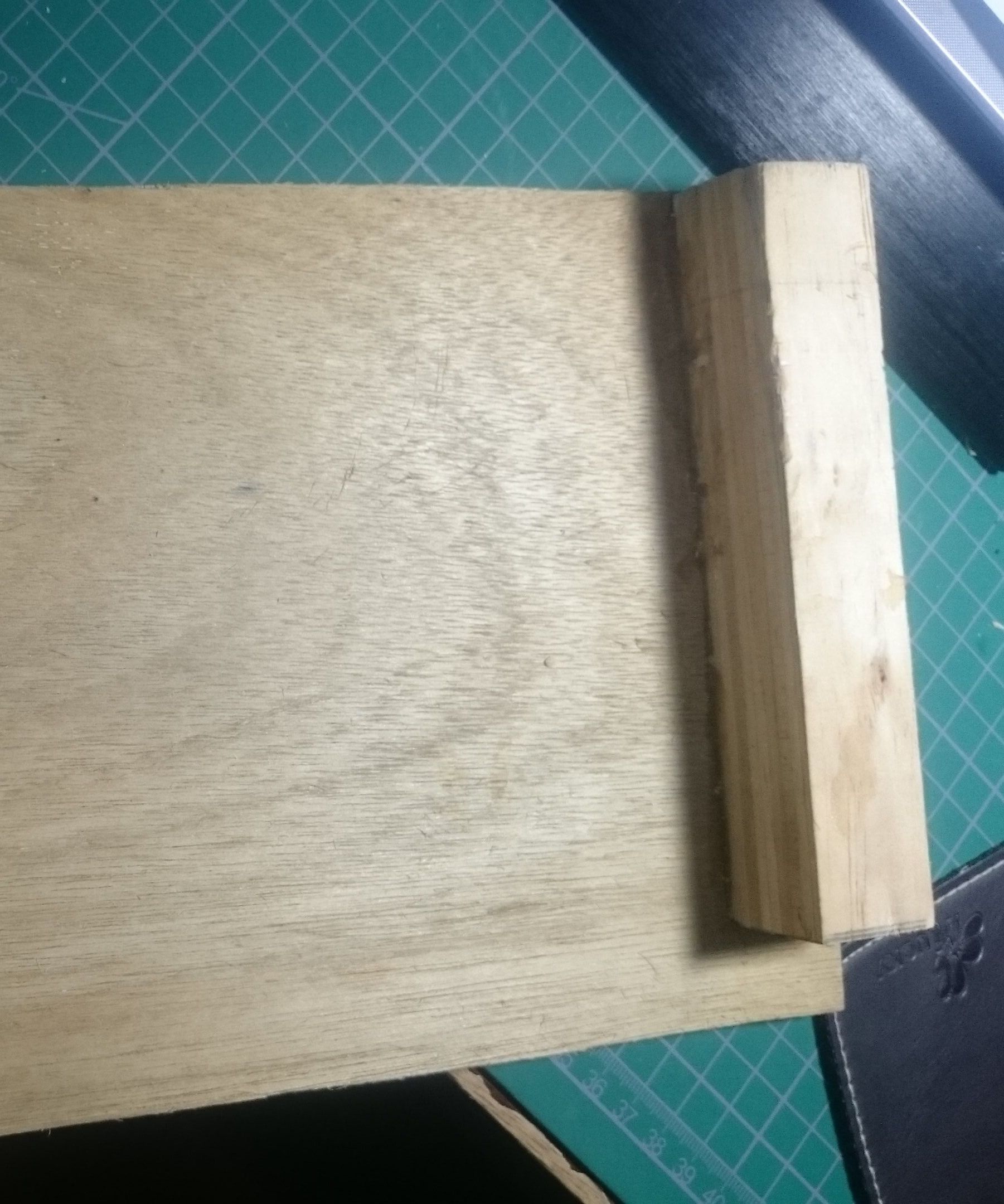

Step 3: Step 3 :Marking Line and Glue Up
Mark the gluing area on both thinner pieces as showing on the photo,
the glue i used is the titlebond 3.
after apply the glue on the marking area, using 2 C-clamps and one mini vise to fix and sturdy it
(it take quite time to make the gluing part fit on the marking part, it was slippy when you start to assembly.)
and go to sleep wait for one night.
